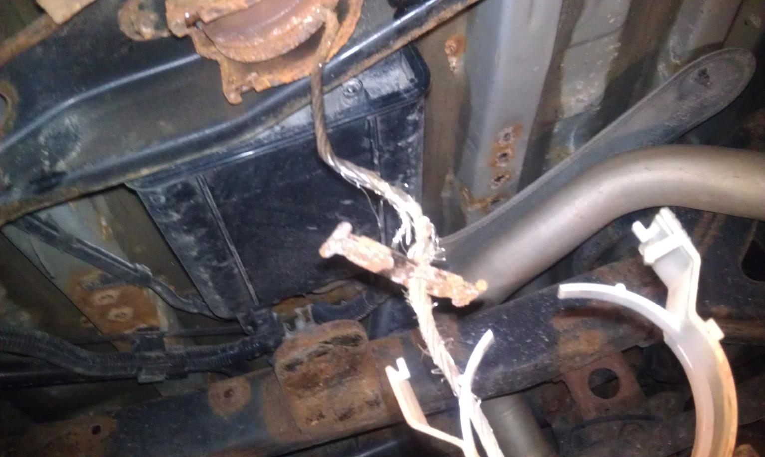

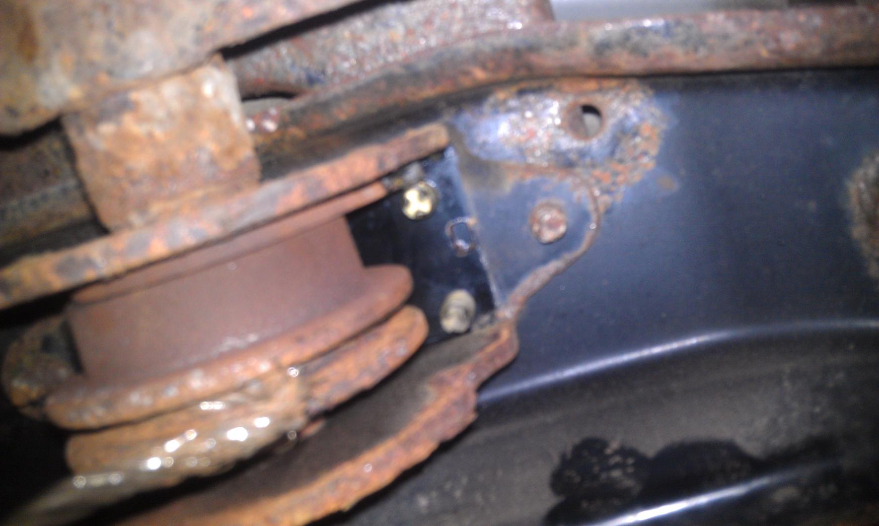

So I was able to get the spare tire down using a breaker bar but as you can see I am still going to need to replace the carrier. Has anybody replaced it? I just don't see how it possible to get these bolts out from the top side.
