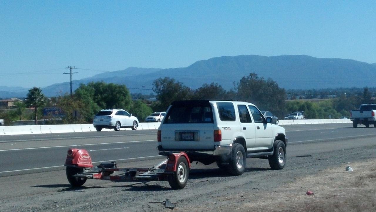

While driving to dolly my Son's CRX Si. I was pulled over by a fellow motorist and was informed that my truck was on fire. When I pulled over i indeed had flames coming from the spare tire. While we were waiting for the CHP to come_ a grueling 5 minutes-. A passing utility truck on the frontage road just happened to stop and he had a fire extinguisher. We promptly put out the immediate tire fire and waited. we unhitched the trailer and dropped the still smoldering tire from the carrier. The fire department doused the tire to be safe.
There was no other damage - save for some rubber that melted and flame marks- that I could see.
When we ready to leave the truck wouldn't start. I have a full tank still- that was a scary thought- fuel pressure at the rail. But the EFI fuse would pop on crank. Had to tow it and the dolly back to the Uhaul.
The next several days I scoured the info on the T4R and Yota tech blogs. I check for crispy wires on the O2 sensors and engine to frame rounds. Still no start. Had to get another tow to the trusted mechanic and wait.

there were 8 burnt wires that were above the the frame that caused the electrical shorts. The fire and resulting shorts ruin the fuel pump and injector circuit. The wiring was repaired ( spliced , soldered and heat shrinked )and the fuel injectors replaced. One of the injectors was grounded out- not sure if it was part of the electrical damage or a prior condition.
The truck is up and running great - My DD and road trip vehicle. I am in the process of retrofitting a swing out carrier.
