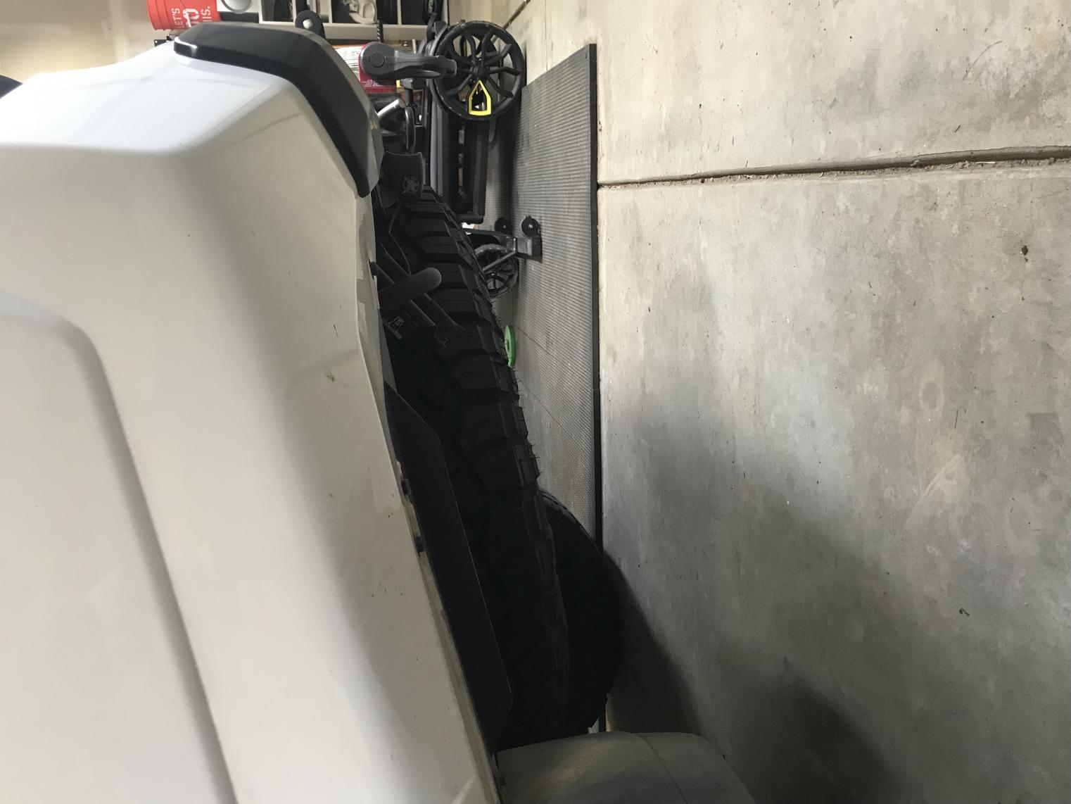

Here is a pic of my 285/70/17 ridge grappler in the stock location
someone on other post said 265/80/17. It would be similar dimension but thinner. So no departures angle issue
Are you sure that is the size you mean?
That would be 2" larger than stock and 1" than 285 70. Also, there are no such tires offered by either Discount Tire or Tire Rack.
Sorry 255 80is what he said, don’t know which tire he referred. but it is really a good idea. To match 285/70/17, 255/80/17 works and is available in market
