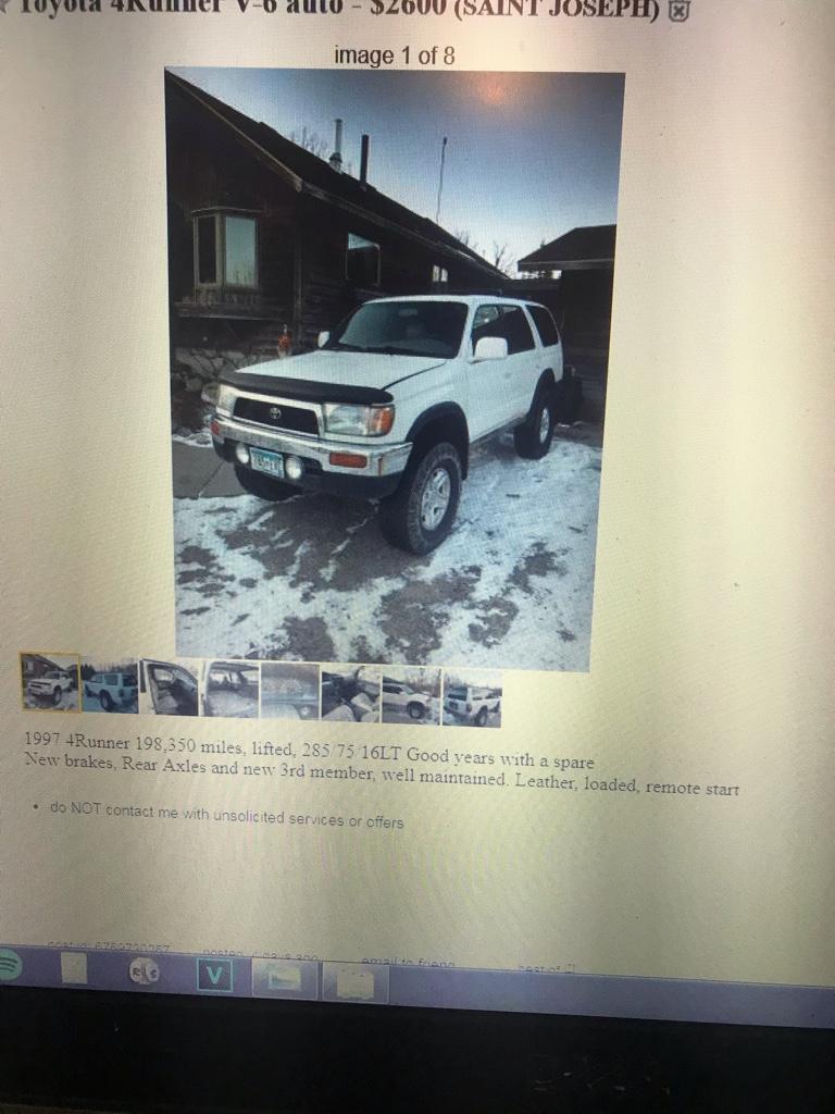

The 4Runner is a 1997. Not sure when the transmission fluid would have been flushed last. I’ve had it about 3ish years and haven’t done anything with it yet. Vehicle has about 230,000 miles currently. Picked it up with about 190,000 miles.
So one concern I have with replacing the transmission fluid is I’m not sure when it would’ve been replaced last. I’ve owned the vehicle for about 30,000 miles and have never done it myself. The transmission fluid was topped off once, didn’t take much and hope that wasn’t a bad idea.
I have heard that replacing the fluid can sometimes cause problems?
I figured since I am already having problems it wouldn’t hurt too much?
Here’s the original ad from when I bought it if that helps at all.
