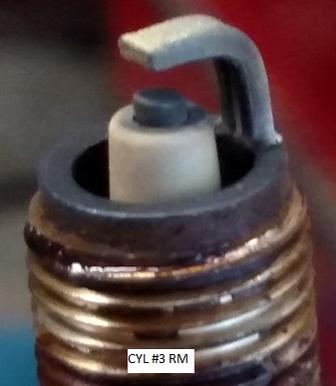

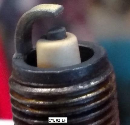

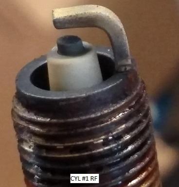

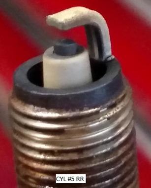

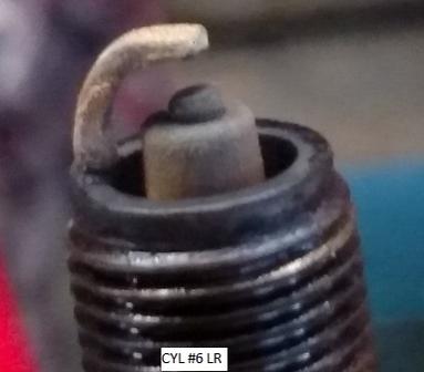

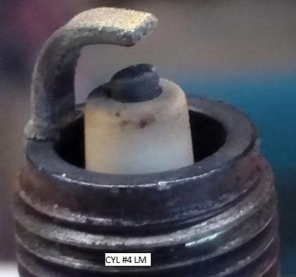

Any how here are the pics of the 95,150 mile plugs. They all gapped right around .055" to .060" just a little out of spec.
Toyota used NGK in one head and Denso in the other. Something like they were assembled at different plants or something. There's a couple theories if you search the spark plug threads.
And the OEM copper plugs are rated for 30k only (which is underrated, but they are cheap to replace). Mine's were never changed out til I brought it home at 142k.
all the 3.4 v6 toyotas were the same as well, the Tacoma guys always freaked at first wondering if it was some shoddy work but Toyota does this at the factory for some reason.
they don't come preinstalled in the heads so they put them in at the factory or where the engines are assembled so they are different left to right on purpose, just nobody (even Toyota) seems to know why lol
Nice pics and you can tell those plugs are pretty worn. I bet the gap is off quite a bit. I'm sure the new plugs will help a lot.
i did my plugs last week, pass side were DENSO, and driver side were NGK, i thought someone must've only changed one side, i guess they were never changed.
