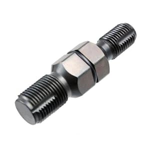

You might want to run a thread chaser thru there to make sure clean them up
sooo tried the aiti seize buuuuuuut nothing.. It always stops and gets stuck in the same place as you can tell when you pull it out and see it in there.
Whats up?
sounds like the previous owner when he put them in ended up stripping the threads. If thats the case getting a new one in will be impossible without rethreading it. Those are a ***** to since you have to catch all the shavings so they dont fall in the block. Had to do it for a mitsubushi I had.
A chaser like the one shown in fourwd1 post will usually work. Dip the chaser in some grease to catch any filings that come off. If that doesn`t work you will have to use a spark plug repair kit.
