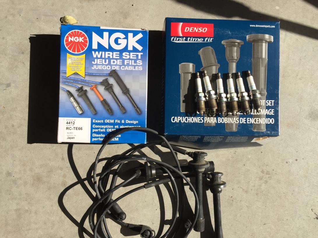

I installed a set of new Denso IK16TT Iridium spark plugs in my 2001 May 24 2016 it had 151000 miles. I still have those same plugs in service engine performance has not changed nor fuel economy. Denso iridiums will last 100,000 miles, or up to 2000 hrs, (100,000 miles) for reference with mobile equipment or industrial stationary engines like Cat 3520C 1 hr run is equal to 50 miles of driving. The pics of the plugs were the old 3 prong.

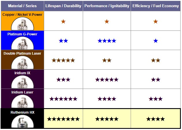

Here is something that Champion has on explaining the performance differences Copper & Iridium vs Platinum Spark Plugs | Champion Auto Parts

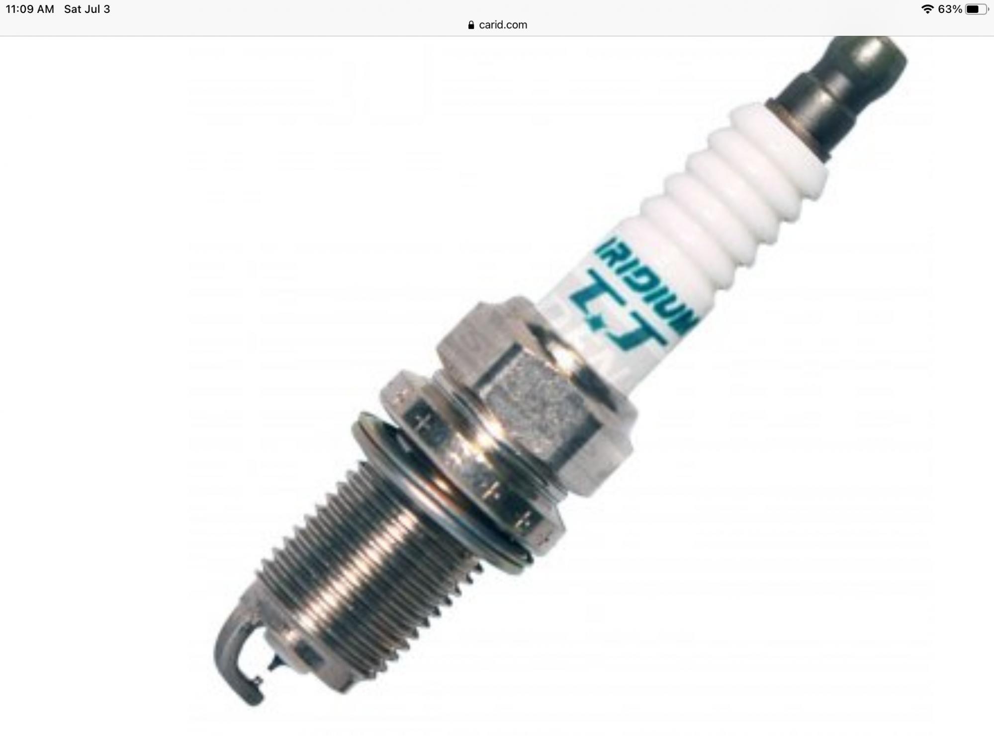

I prefer Denso because of the double iridium tip. Yeah it’s more $$ but I don’t want to change plugs at 30k miles, there is also the impact on fuel economy as the plug wears. It’s really preference.
