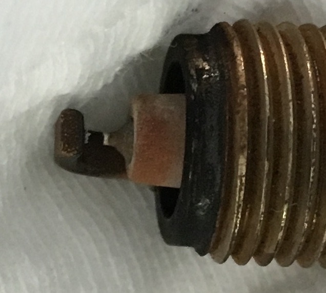

I first replaced mine at 6 years and 81,000 mi. They weren’t hard to remove but there was a lot more resistance than I was comfortable with in an aluminum head. I pulled them because I just wanted to check condition, and try my new wrench. I found a lot of deposits on the ground electrodes and gap was way off. I replaced them rather than clean and regap. This month I checked them again and decided to replace them again (135k). Same issue, a lot of deposits and gap out of spec. Maybe it’s that California gas?
I kept my 120,000 mile spark plugs and labeled them with the bank and cylinder for comparison on the next change at 240,000 miles. Overall, mine are cleaner than the one you show. The worst of them is about the same except all plug grounds have less deposits. Phoenix has a special gasoline blend to reduce air pollution (which increases our fuel cost). The gap on my plugs is typically 0.001 inch over spec when measured with pin gauges. I don't know why the gap on your plugs increased.
