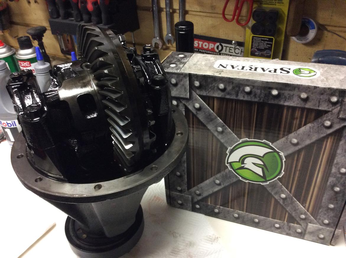

Been running mine for a few years now. I've wheeled the piss out of it on some of the hardest trails around(John Bull, Calico)and it's held up admirably. If I had the $$$ I'd definitely go ARB, but if your on a budget, you can't go wrong. Plus it's fairly easy to install.

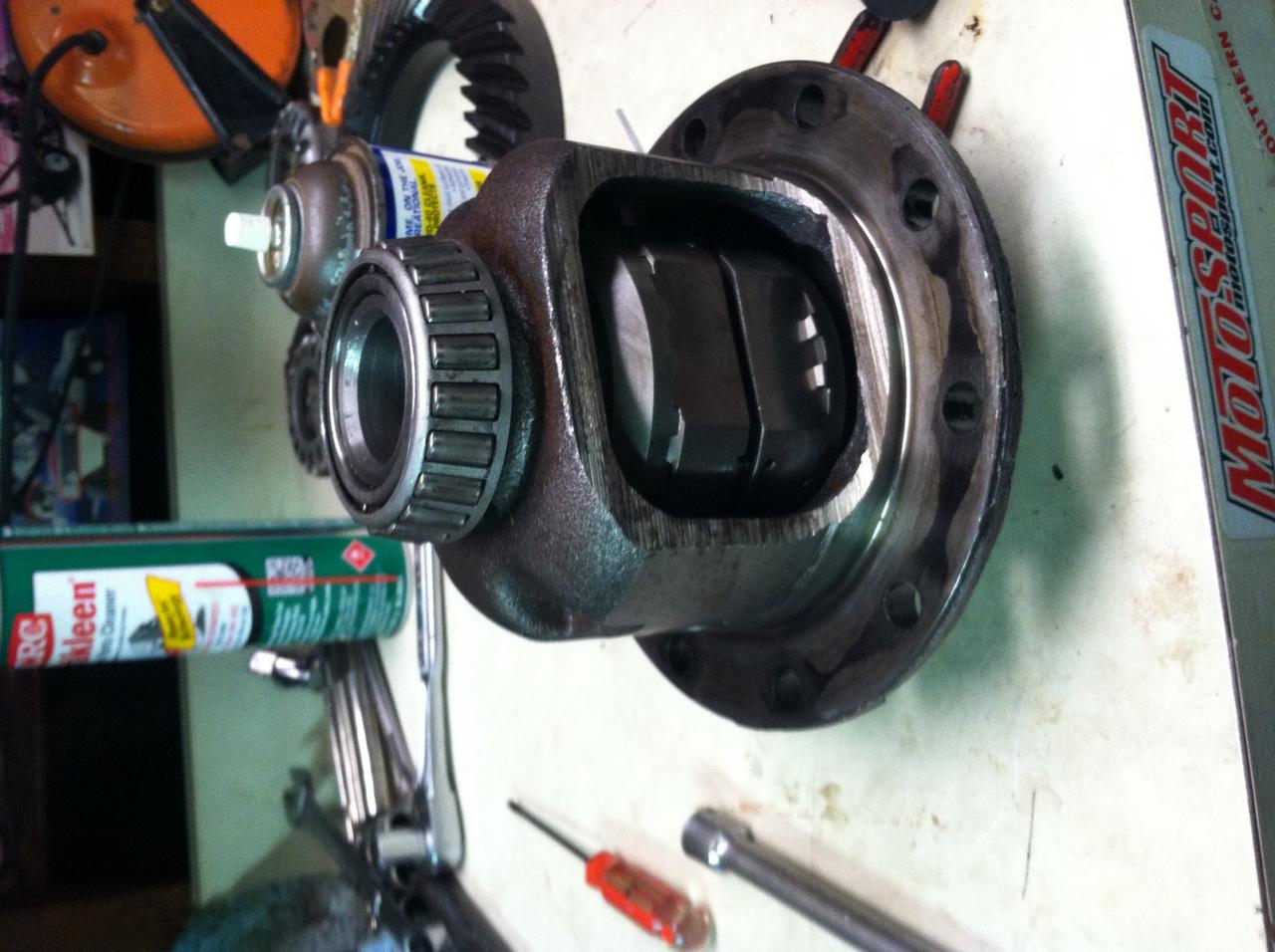

Been running one in my 4th gen for a few months now and it's our DD and I've ran it hard hard in every type of terrain thus far and love it with no issues wish I would have done it a lot sooner. I'm actually about to buy another for my 3rd gen. Spartan lockers shred ...
