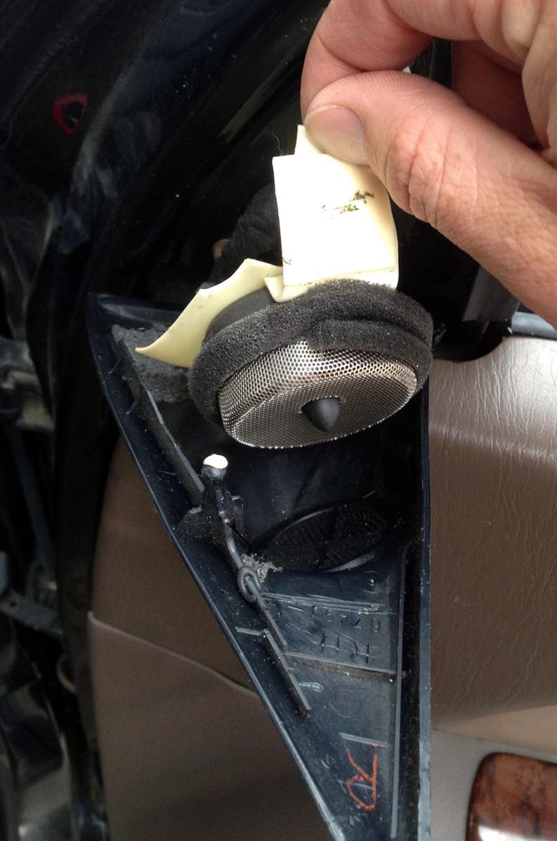

any problems with fitting? modifying of door panel?
No problem with fit in the stock location. Hardest part was removing the speaker from the housing because of that industrial strength glue they used. Epoxied the tweeters using the stock bracket.
removing the factory speaker? does the alpine secure to the mount the same way? i just may get those. i'll keep my OE tweets.
That's a Coax speaker, not component. Why are you epoxying tweeters? Am I missing something?
He has to be referencing a component set. I just used industrial velcrow to mount my tweeters to the oem bracket.
