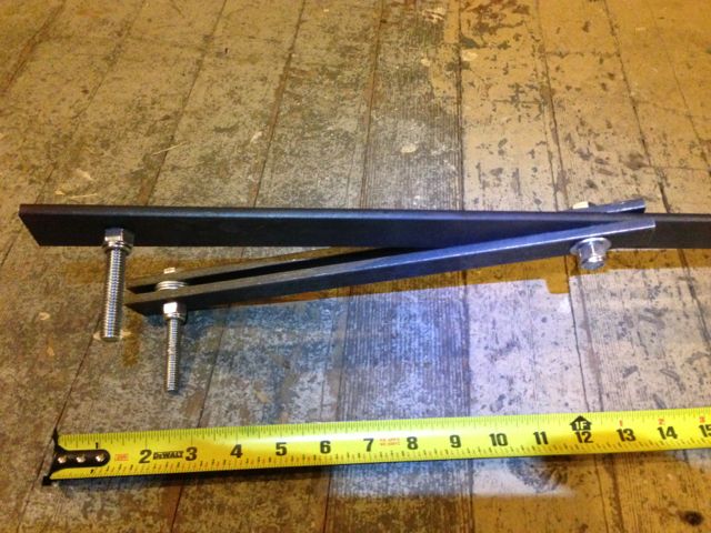

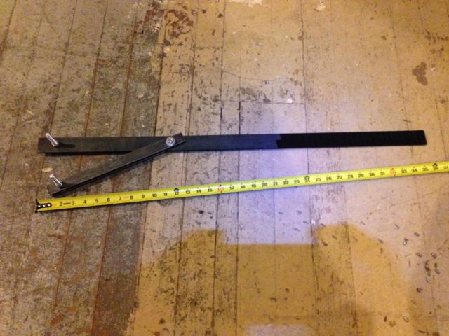

Deep 6 point socket. breaker bar. torque wrench (50-250lb from auto zone free tool rental). Be careful with loaner torque wrenches as they may be out of calibration. Special service tool (SST) from toyota, or make your own. Goog 'home made toyota special service tool 4runner remove crankshaft pulley' or just buy one. I made this:
That's great. Thanks for posting that up. I think I will make my own rather than buying one now that I have seen yours.

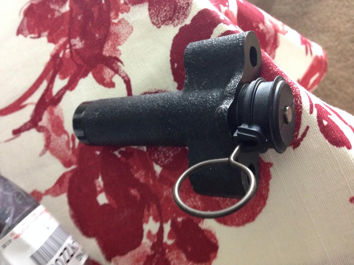

I'm actually going to do this job this weekend and had the same questions. Is this photo of said part that needs to be compressed with vice?? Wouldn't impact gun eliminate the need of crankshaft special tool?
`1. Yes. This one is new and comes pre-compressed. That's what the wire thingy does is keep it compressed.
