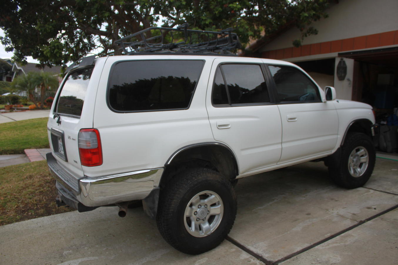

Woot woot! Got my lift installed. Here is a before and after. I bought my runner a few months ago with the suspension totally shot. Now it feels like what I think it would have felt like buying brand new 18 years ago.
