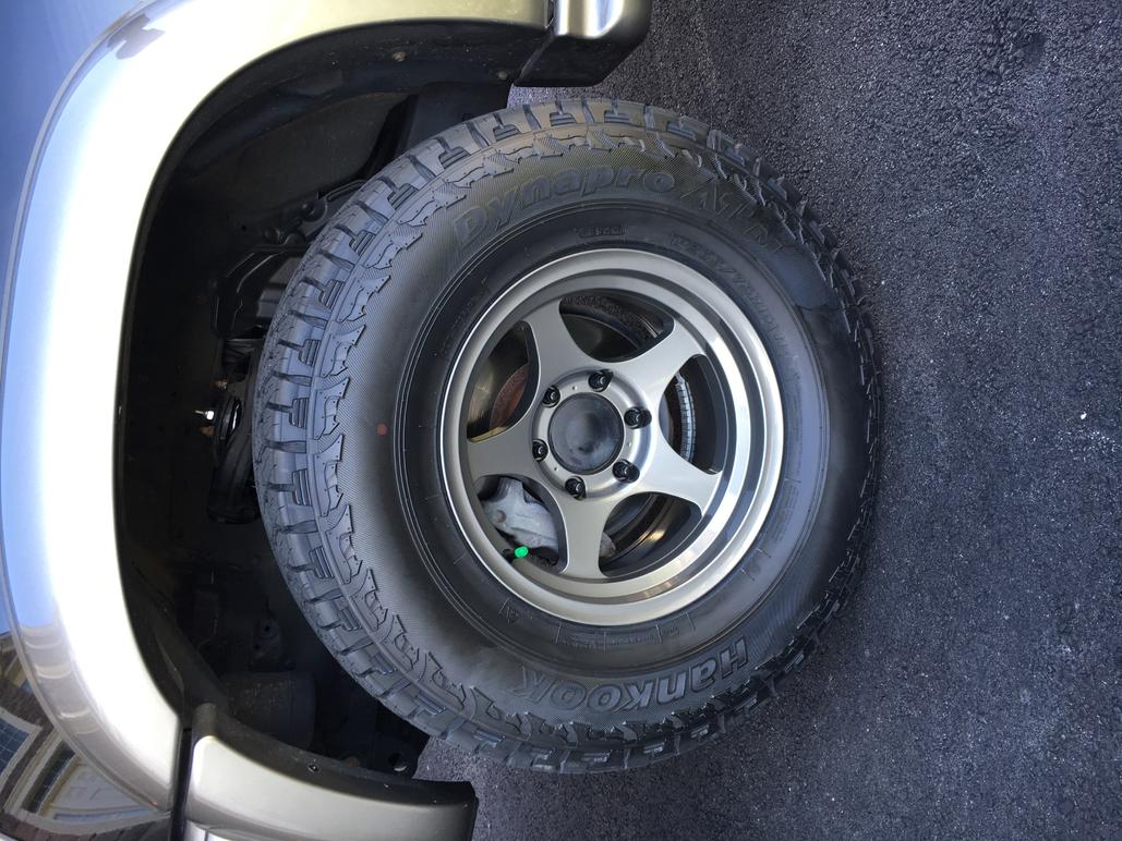

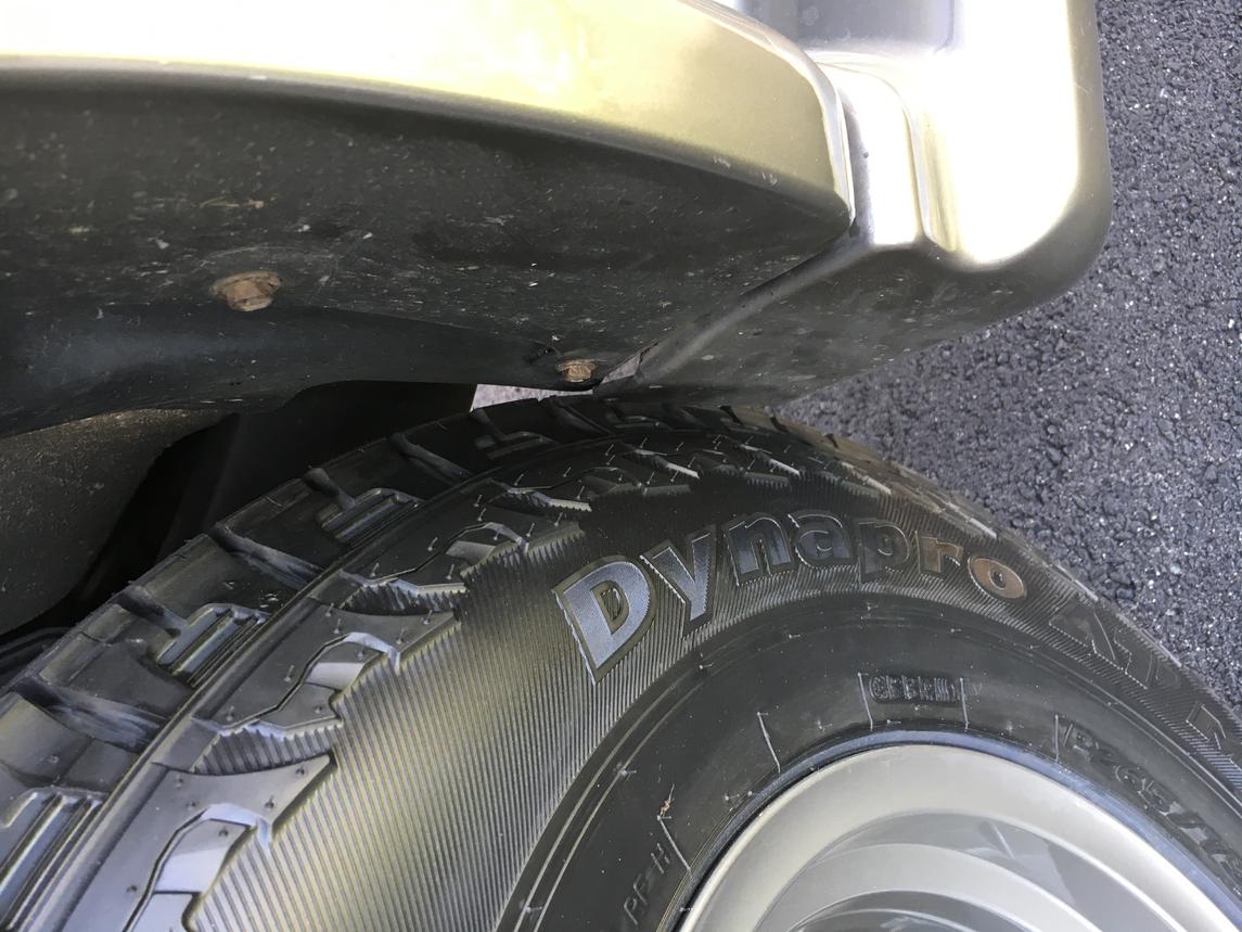

I followed your video to the "T" and im experiencing rubbing on the front end where the running board end cap touches the tires on both driver and passenger side.
Im currently on the same lowest setting you are on for the 5100s. What would the implications be if i raised the bilsteins up to the next notch? Id rather not remove or trim the running boards if I dont need to - looks awesome with them on
Also, in your video it looks like the "after" measurements in the rear are about .5" higher than the fronts. Do you think it will level out?

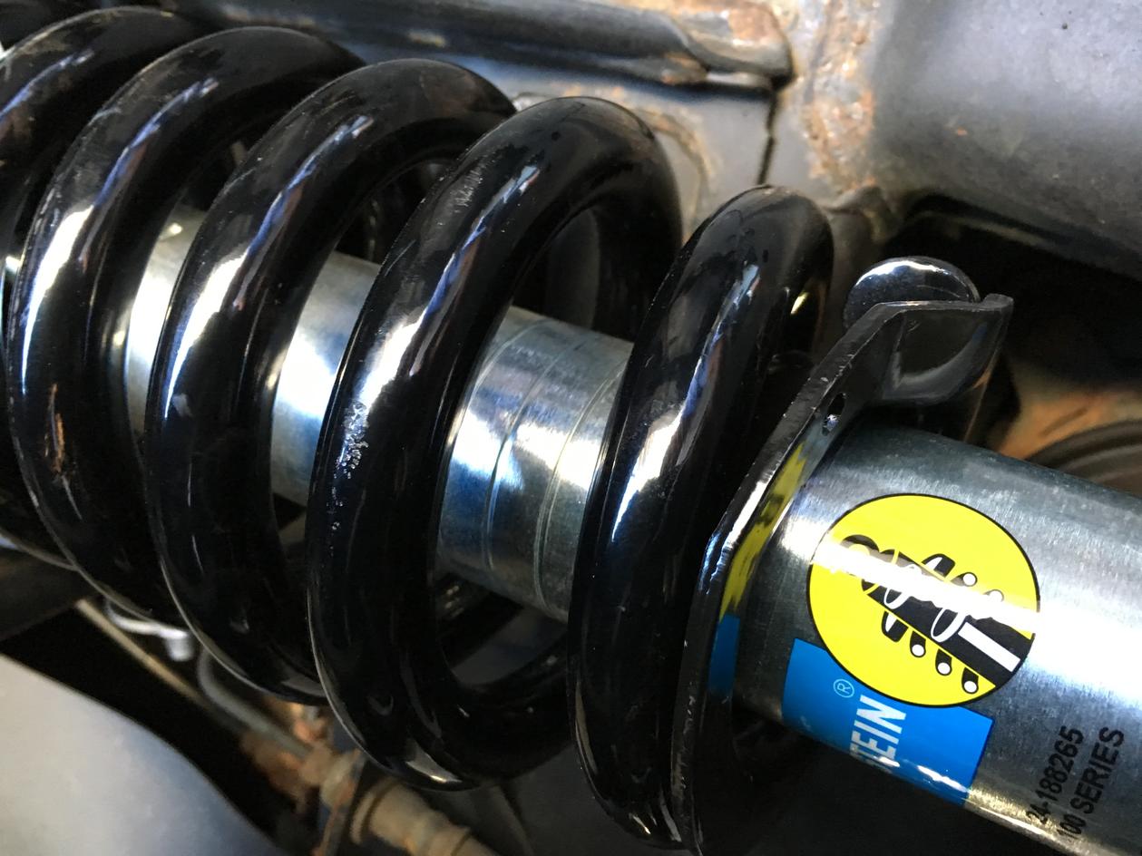

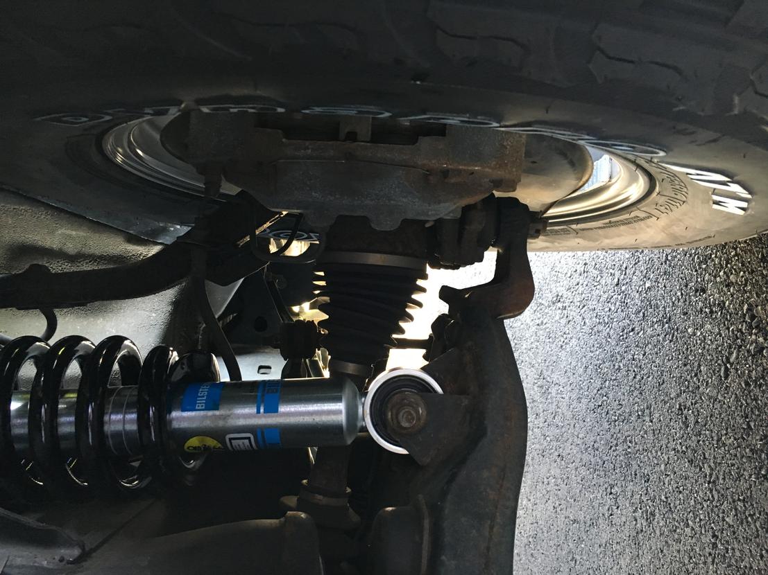

Pictures:
Continued

If I were you, I'd ditch the running boards altogether. Get some tube steps or sliders and call it a day.
I've not run on the 2nd perch, so I'm not sure I can't give any good info. I can tell you that you need to be mindful of the CV angle so as not to wear out the boots.

Did a little more digging, looks like the tire is actually rubbing on that bolt head/fender liner in the picture above so removing the running boards most likely wont do anything unfortunately

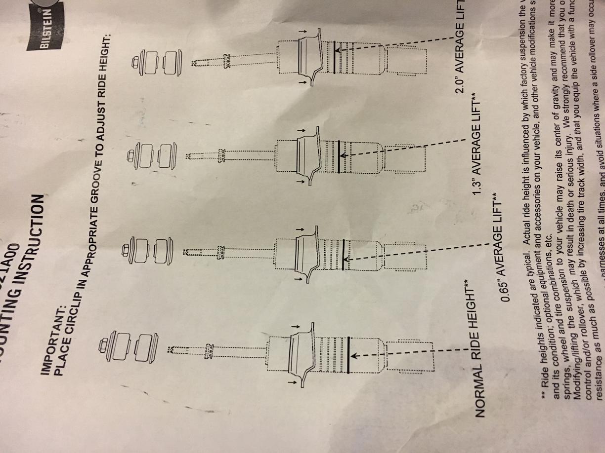

Looking at the Bilstein diagram ive attached - will it be a total of a 2.65" lift? (One notch up adds .65")
Lastly do you or anyone know the negative effects of going the additional notch? Ive "read" a 3" lift is where you have to do all the safety precautions, diff drop etc.
Not sure on the shock measurement question, but in KISS terms, did you try tightening the bolt a few turns? That may just do the trick. I have about 1/4" or a bit more between that area and my tire.
Tried tightening the bolts unfortunately didnt help
