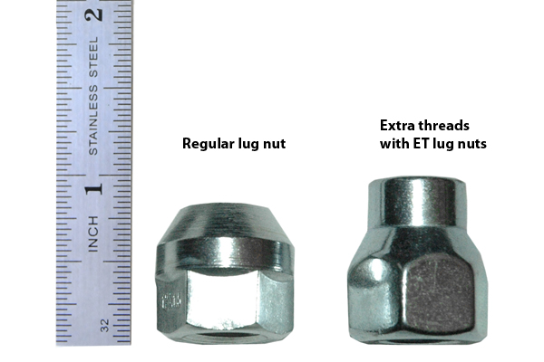

All Pro sells these to go with the spacers for the front. Did your spacer kit come with something like this?
