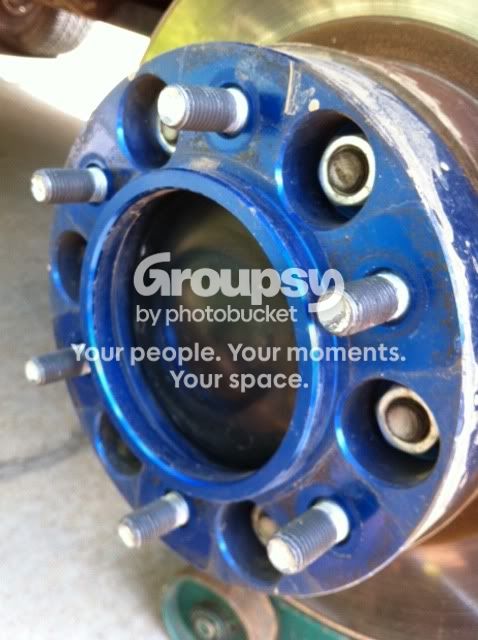

Ok, I got an email back from Spidertrax, so if I wreck and get real hurt, I blame them....lol
Here it is:
Dear Geoff,
Thanks for the email and the link to your install photo. Although I would agree the photo “looks” questionable, rest assured the amount of tread engagement appears to be correct.
In an effort to avoid improper installation of lug nuts, we have opted to include "bulge" style lug nuts which prevent the lug nut from being installed backwards. As a result, the lug nut is much taller than OE so it ends up having unused threads.
For an OE application using M12 or 1/2" studs (fine thread) you would like to see about 0.550" of thread engagement and your photo appears to be there. As an interesting comparison, check out this photo which shows the installation of a bulge style lug nut and a non-bulge style lug nut on your spacer - http://files.spidertrax.com/images/whs007_lugnut_install.jpg . Although the non-bulge style lug nut appears to have more thread engagement the fact is both lug nuts have the exact same engagement in this shot.
If you have any other questions or concerns regarding your installation please do not hesitate to contact us anytime. We are always happy to help.

I am glad it is turning out okay. I've looked at this thread many times waiting to see if it has been fixed yet! Post some pics up when you get a chance!
Looks like we are OK! :-)
Thanks for taking the time to post the response from Spidertrax. I installed Spidertrax recently and my fronts look like yours and not like J.A's for some reason even though I have the same year/model as he does in the picture on the first page. Good to know I don't have to worry about them, I wonder why the front studs are shorter or if they are the same length and the hub is just wider.
I know that Spidertrax said it was ok but I still would put long studs in. You never know who might work on your 4runner in the future and over torque those nuts and strip them out. Replacing 12 studs is easy and will probably cost you $24 .
Definitely worth the cost of a Movie date for 2.
Longer studs seems to be a likely fix, seat them tight and you should be good to go.
Good luck.......regards 8sm
I replaced the OEM hub bolts on mine with 1/4" longer knurled studs, now the Spidertrax nuts are even with the tip of the bolts when tightened. I get better piece of mind.

Now see this is exactly why I myself shy away from spacers that large lol.. Now I understand with some wheels there's just no getting around it but still, If it were me I'd be buying longer studs just for peace of mind regardless of what some desk jockey says. I'm running a 5/16s spacer with the stock wheels- also did longer studs. Its an easy swap do it exactly how liny said and you'll be golden.
Now see this is exactly why I myself shy away from spacers that large lol...
You're missing the logic of wheel spacer/adapter here. 1.25" or 5/16" spacer doesn't matter, it's the same idea..only with the 1.25" you use a different set of wheel studs to mount the wheels onto, with the 5/16" you use the originals studs.
The reason for replacing the stock studs with the longer ones is because, both spacer application shortens the effective length of the stud & nut tread engagement when you mount the wheels.........by about the same amount of 1/4'- 5/16".

I pulled all 4 wheels just to check my spacer bolt torques. Every nut was to spec. I also took a picture on my front. My lug bolts come past the nuts that Spidertrax supplied.

Look at the difference in size between the nuts they provided on May last year when I bought mine, compared to the nuts that came with the kit I bought yesterday for my brother...1/4" shorter this time.
That was the reason I changed my bolts, because of the longer nuts which went past the stock bolts.

I'm confused. Sorry but is the good one on the left?
If Spidertrax is now shipping the shorter nuts then shouldn't the bolts be sticking out of the nuts instead of being recessed? I mean those bolts are actually still the factory wheel bolts correct?
