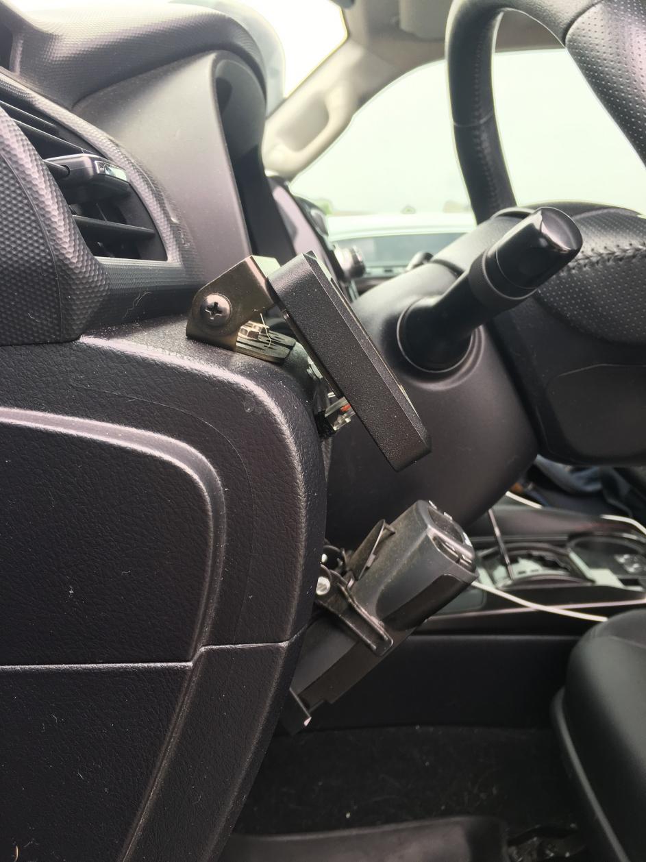

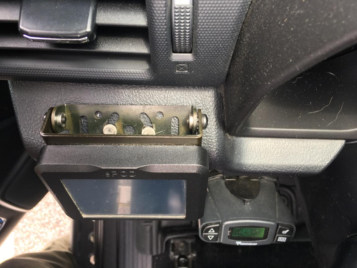

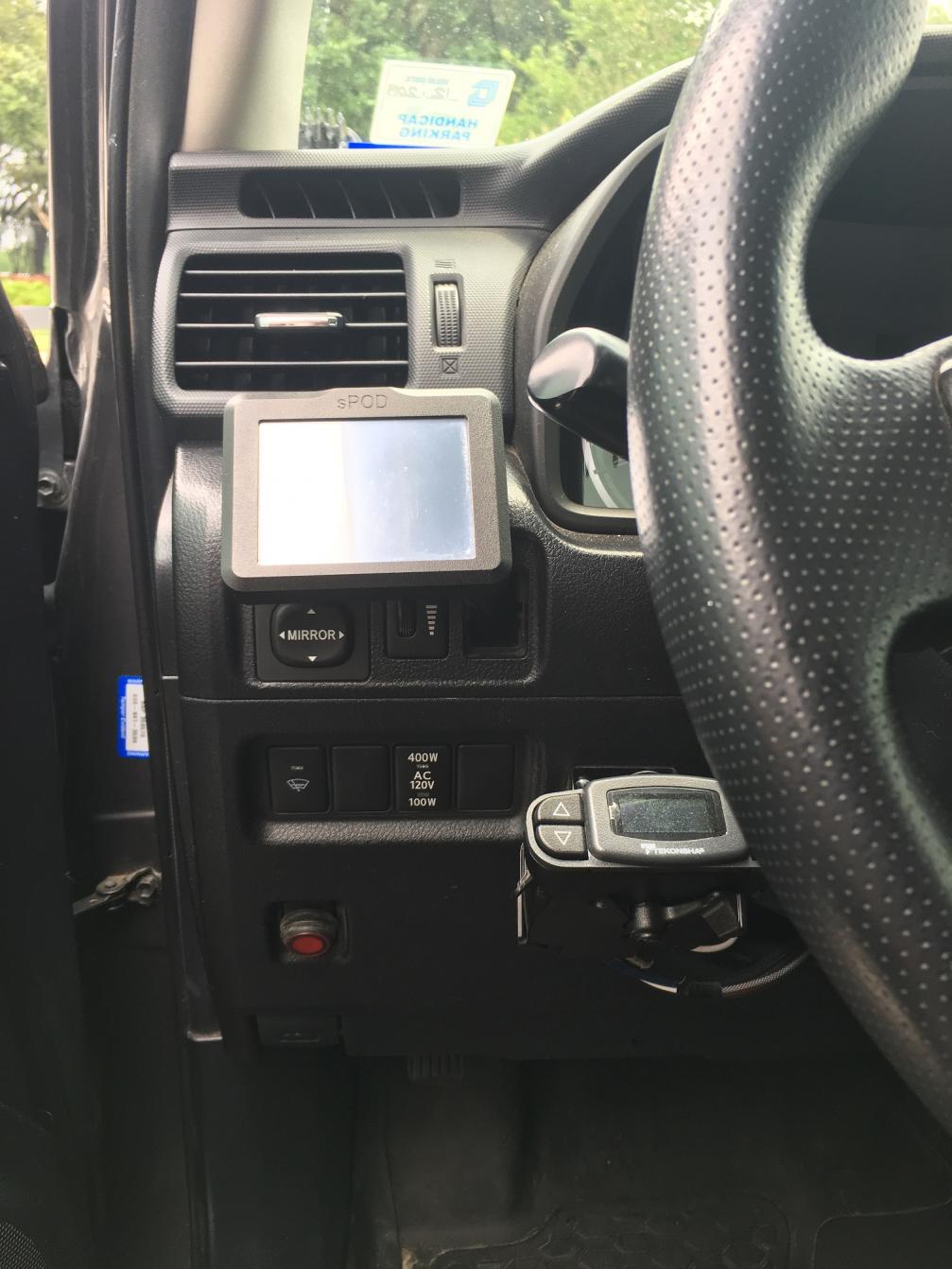

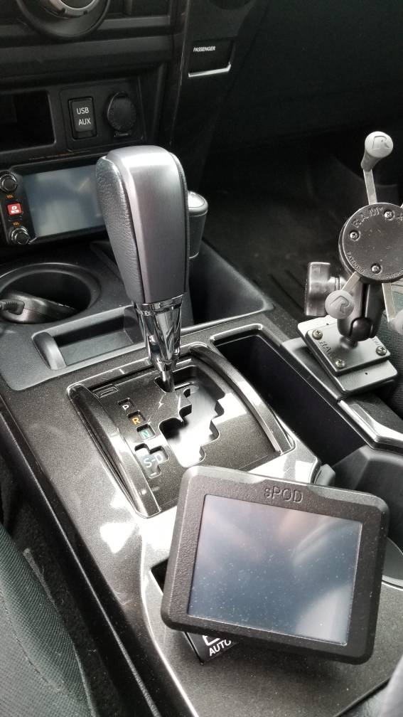

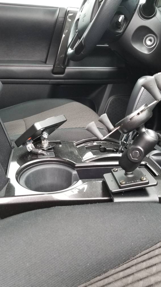

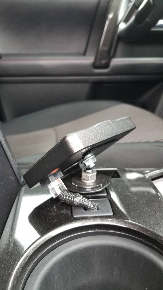

i haven't experience screen or button lag, the screen is pressure activated, not heat, so you do have to be somewhat deliberate in pressing the switch button, so at its worst it occasionally hasn't registered my initial "push"
couple pics of how i have it mounted, bracket upside-down / screen right-side-up

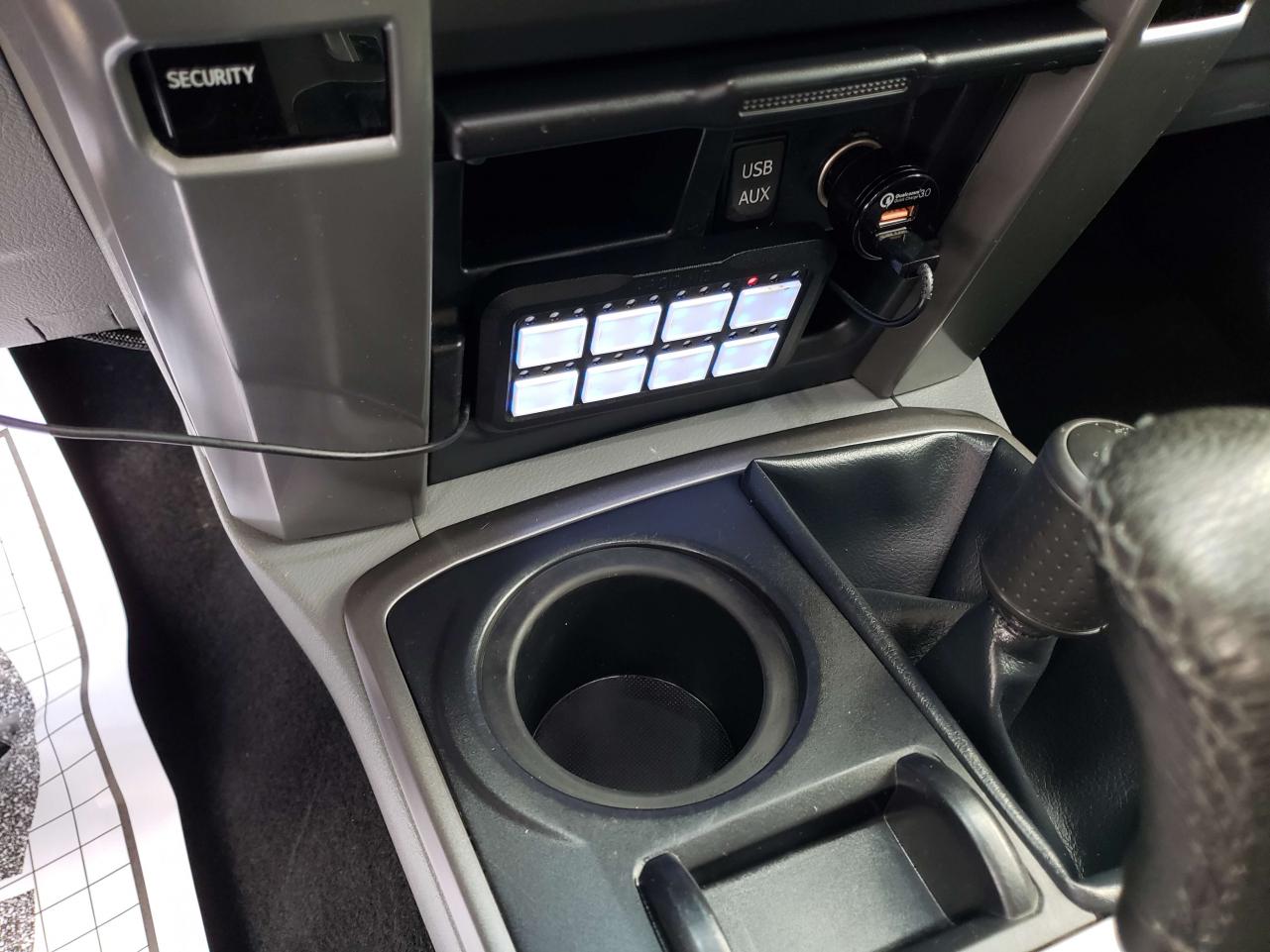

So why not the HD Switch Panel? Everyone I talked to said it was much better than the touch screen and as far as I know all the features are the same. I have one and love it. No lag whatsoever
Customer service has been great. I have a variety of lights hooked up and a compressor.
The app is really basic but I haven't had any issues with it.

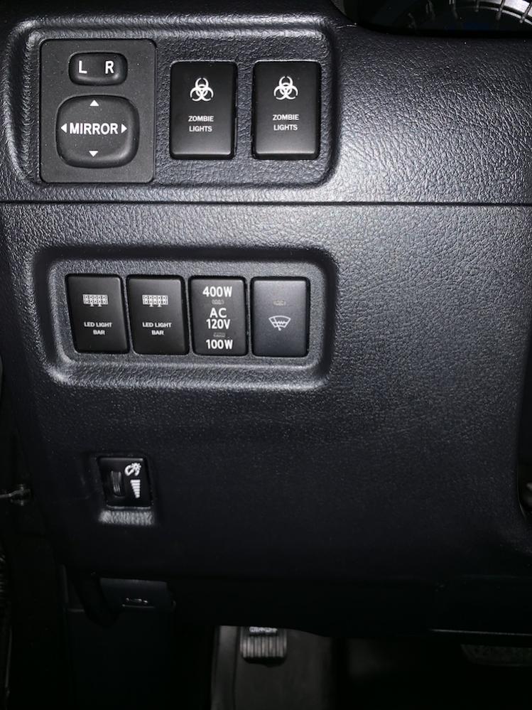

I was torn between the sPOD and Switch Pros. Quite frankly there was too little information available on what everyone thought and it seemed as if it was really personal choice.....Toyota - Ford - Chevy, you know what I mean. One of the deciding factors for the sPOD was that it could use alternative switches like the AOB ones. In fact, I have already installed 4 of them with the 5th one to go where the Party Mode switch used to be in the early 5th gens. I like pushing a button but like high tech too. Probably [MENTION=98117]comtn4x4[/MENTION] is right, shoulda went with the HD instead.

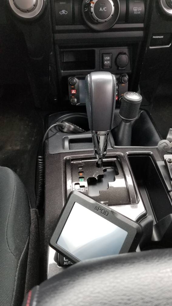

Any chance you could provide a measurement for the display? After having it for a little while now, any regrets? Thanks
