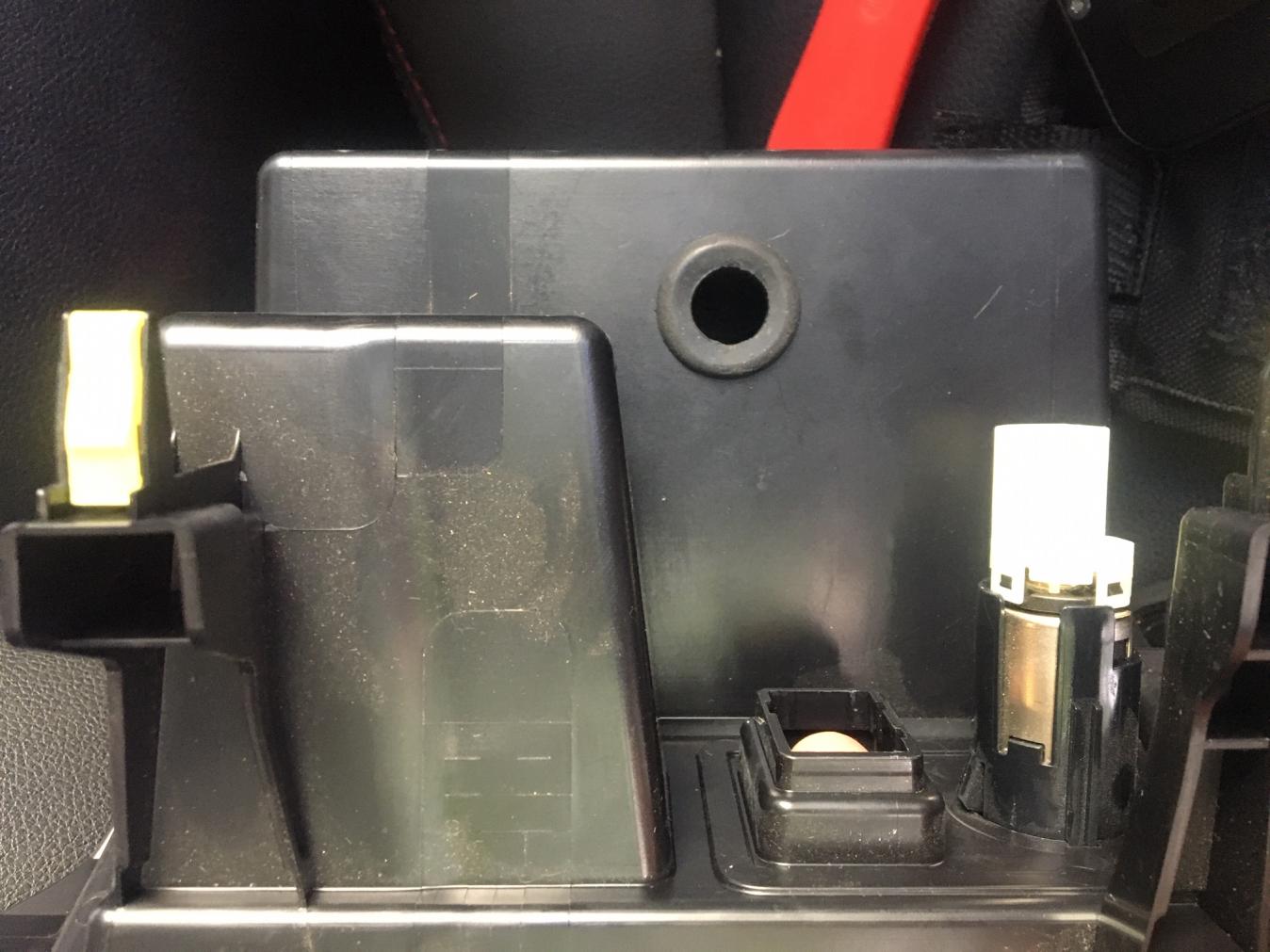

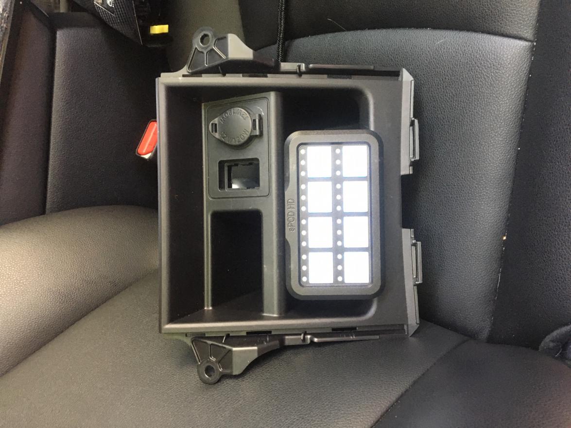

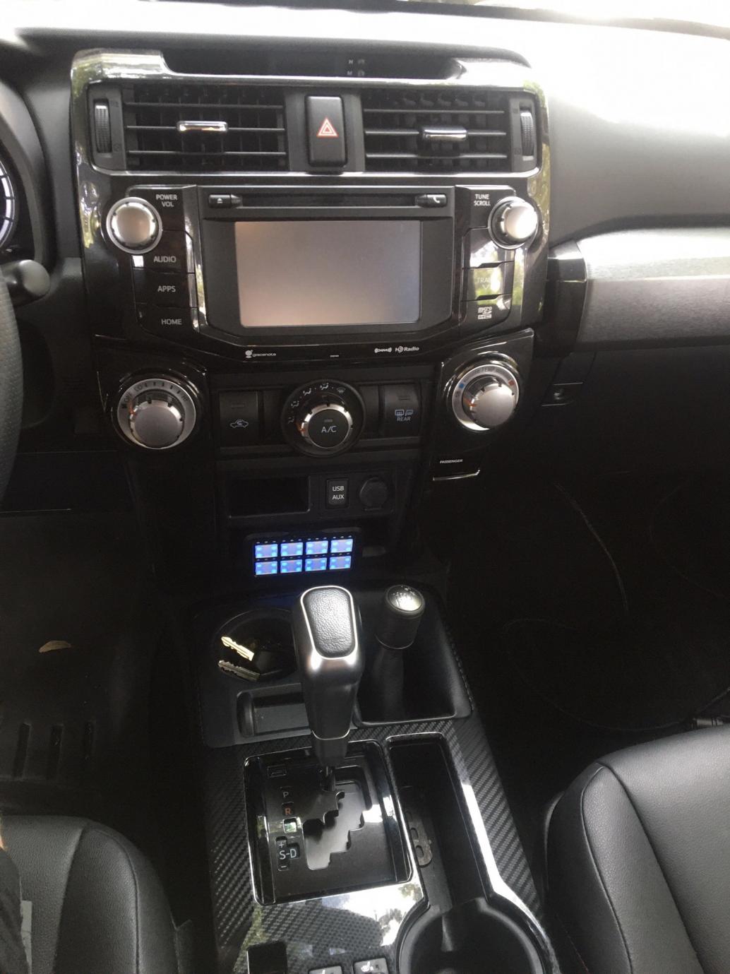

I completed my install of the sPOD HD panel. I used the universal mount that came with it. I drilled the holes for the mount and power cable on the top of the cubby instead of the bottom so if I ever remove it there aren’t holes in the cubby that would allow small items to fall through. I used washers on both the underside and topside along with a star locking washer under the nut. Those went through the elongated mounting holes of the mounting plate so I can pull the panel forward a little to gain access behind it. The panel actually slides about an inch forward using elongated (slot) holes. The picture of the large hole with the grommet is there to run the cable through. I have access to the rear of the HD panel and can unplug the cable if necessary. Turned out great and happy with the install process.
