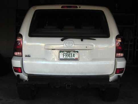

My son-in-law got a stock SR5 third brake light for me so I installed it today. Since his kids spend quite a bit of time in my truck I think he liked the idea of better visibility. The install was pretty easy, mark the metal to be removed, cut it out with and angle grinder, extend the wiring, splice it in and pop in the light.
Crappy pic but you get the idea.

I'm not a fan of the spoiler anyway so I'll add the SR5 BlackWorks mentioned. All that's needed is a few minutes with an angle grinder to cut access for the wires and mounting. That and filling the holes.
I'm curious how your rear spoiler removal went? I have an 01 that has the spoiler on it and I really want to remove it. I'm just worried how the sealing of the holes will go...
I filled the holes with plastic plugs, a bit of filler and painted the area. I'm not a sticker for appearance since I wheel a lot and have plenty of pinstripes and minor dents here and there anyway. I'm sure a nice job could be done while the light is out bu reaching and patching the holes then.
