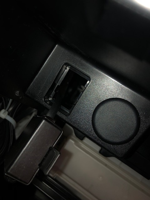

1 is where i got the blank panel from the glove box, i chose this one because its flat unlike the rest already in the dash.

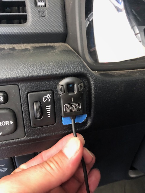

2 is how i taped a line to know where the bottom would be

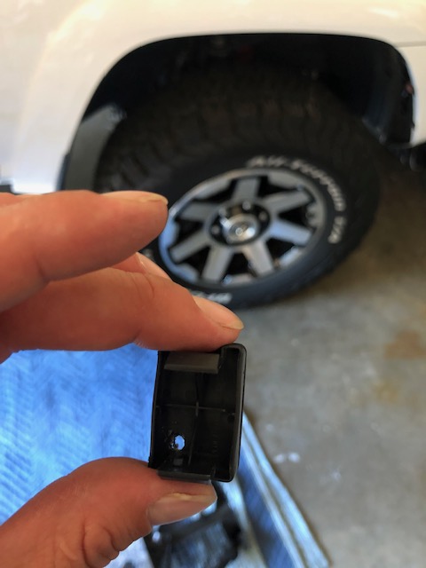

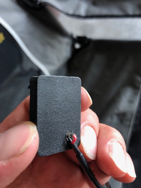

3 is where i drilled a hole to run the wire.

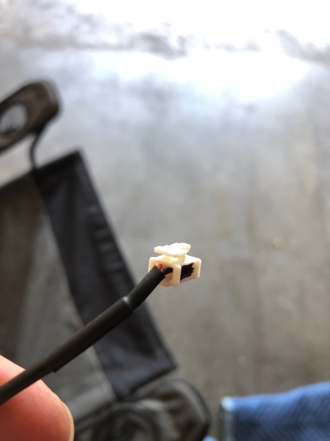

4 shows the plug of the controller you need to take the wires out of, i marked the one side black so i didnt reverse the red and black wires.

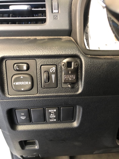

5 shows how i ran the wires through the blank
6 is the finished install
