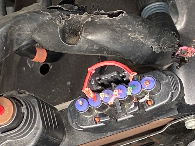

Hey all, first time in here. I have a 2016 4Runner SR5 with about 50k clocked.
I went out the other day to drive my 4Runner and all the sudden the check engine and TRAC OFF light was on with no power (limp along). After some researching I found that squirrels crawled up in my engine compartment and chewed up my wiring to the Air Injection Drive Control Module.
Do I need to replace the entire harness or can I get a pigtail connector to solder in place to fix the issue. Not a good time for xmas to be stranded :( The squirrels also got into my minivan and chewed up the air intake system twice along with the hood insulation.
Anyone else have squirrel issues and how do you prevent them from doing it again?
Thanks in advance for your info.

Squirrels do this crap as well? I thought it was only rats/mice. For a rat leave the hood open. Sounds like a squirrel would thank you for making it easier. Some insurance carriers will cover animal damage, some will not. So check. Do that first before you tamper with the evidence. If you can purchase just the plug you might be able to splice it in. Wouldn't hurt to try depending on what the dealer charges for the part.

Well it could be possible field mice but no signs except for the chewed up wiring. I did buy some sachets for mothballs and hot spray to put around the engine compartment.
As to replacement, toyota doesnt sell the pigtail connector, but I found them aftermarket. Just takes the time to ship....

Sorry for reviving this thread. I just found out I had the exact same issue with the same wires being chewed straight off on my 2013 4runner. I've replaced the wiring harness before due to a similar issue elsewhere on the vehicle and would like to avoid that pricey option.
Were you able to just solder on a new connector? Thank you so much.
