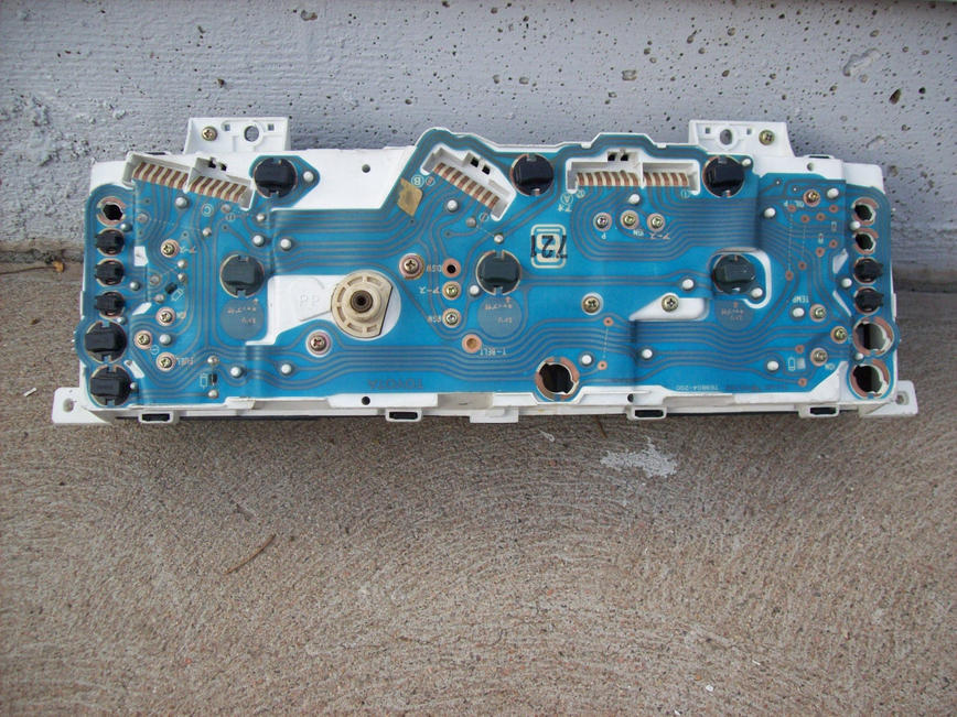

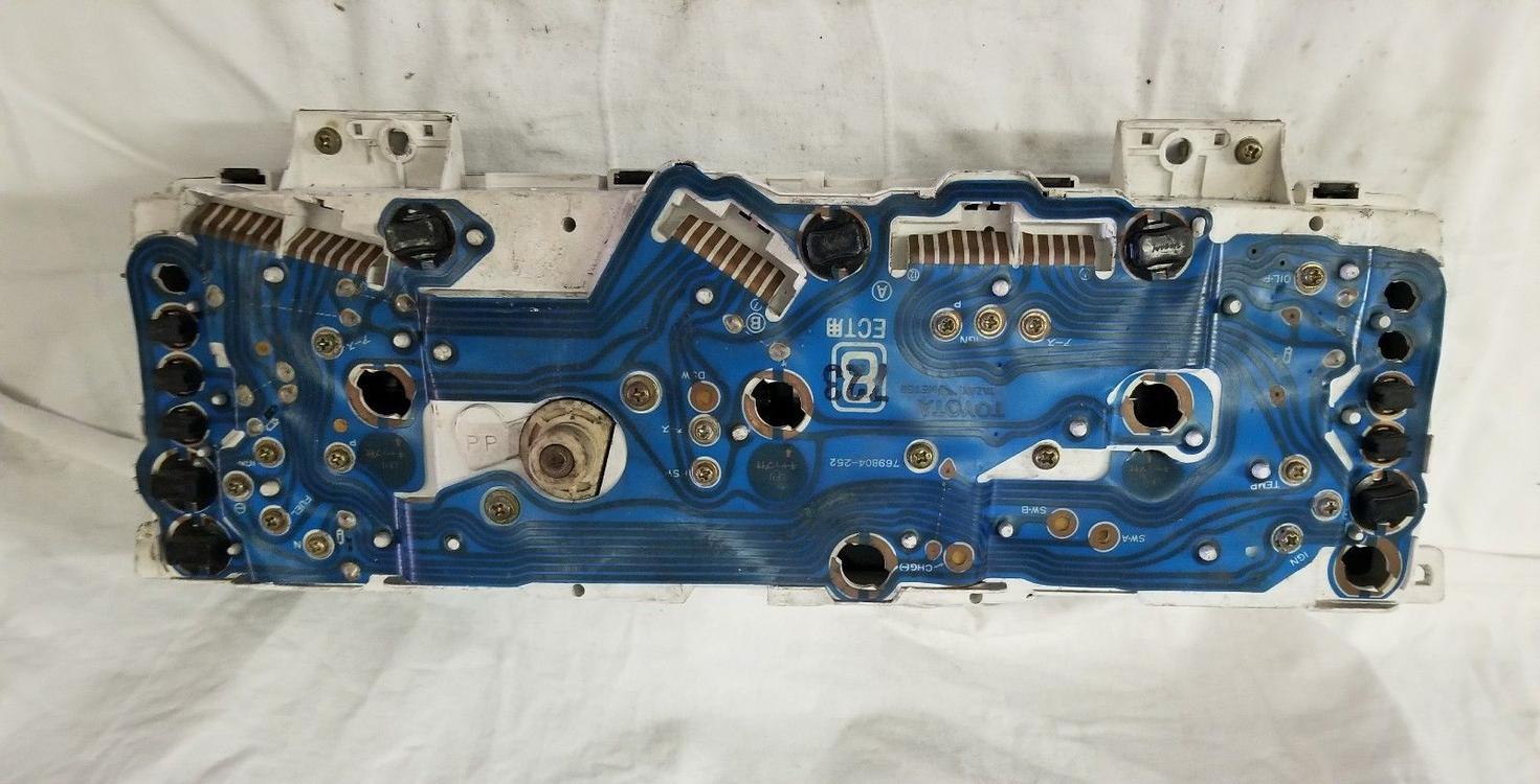

The screws appear to be in identical positions across all dashes, and the only difference seems to be the wiring on the back. I attached two pics othat hopefully explain my point, auto is 1990 the manual is from 1987. (dirtier cluster is the auto cluster).
