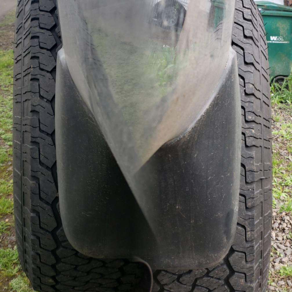

a photo might be helpful.
Not sure what photo would be helpful honestly. Here is a quick on I put together the other day. SS Panhard in at correct length. I can take more tomorrow. Had a late work day today and don't feel like crawling under it right now.
We need a photo of the panhard mount on the axle, the panhard mount on the frame, and a wide angle overall look at the panhard bar.
About all I can think is that something is bent.
Your saying the stock bar has the axle to the drivers side and the SS bar also has it to the drivers side.
Yeah the ss panhard was just a tad longer than the stock one. I did follow his directions carefully and started at the one inch mark for best accuracy. It was pushing left with the stock panhard before hand.
I did mess around with it some yesterday. I unbolted frame end of the panhard, unbolted the sway bar and jacked the back end of the frame up. Both tires measured the same distance from the frame at that point. Lowered it back down slowly and the axle shifted back left some. I ended up man handling the rear axle and frame the best i could to align it. Well align the tires with the frame. I got it close but not spot on. I know that in order to get it as close as i did i had to make the ss panhard SHORTER than the stock panhard. I know something isnt right but i dont know what. Everything looked good to me..
Do you know if it was in a previous accident? May be worth taking it to a body shop/frame shop to get it checked. How much shorter did you have to make the ss ph to get it closer to normal alignment? Anything underneath look bent or misaligned? Both brake drums, wheels, etc securely on?
