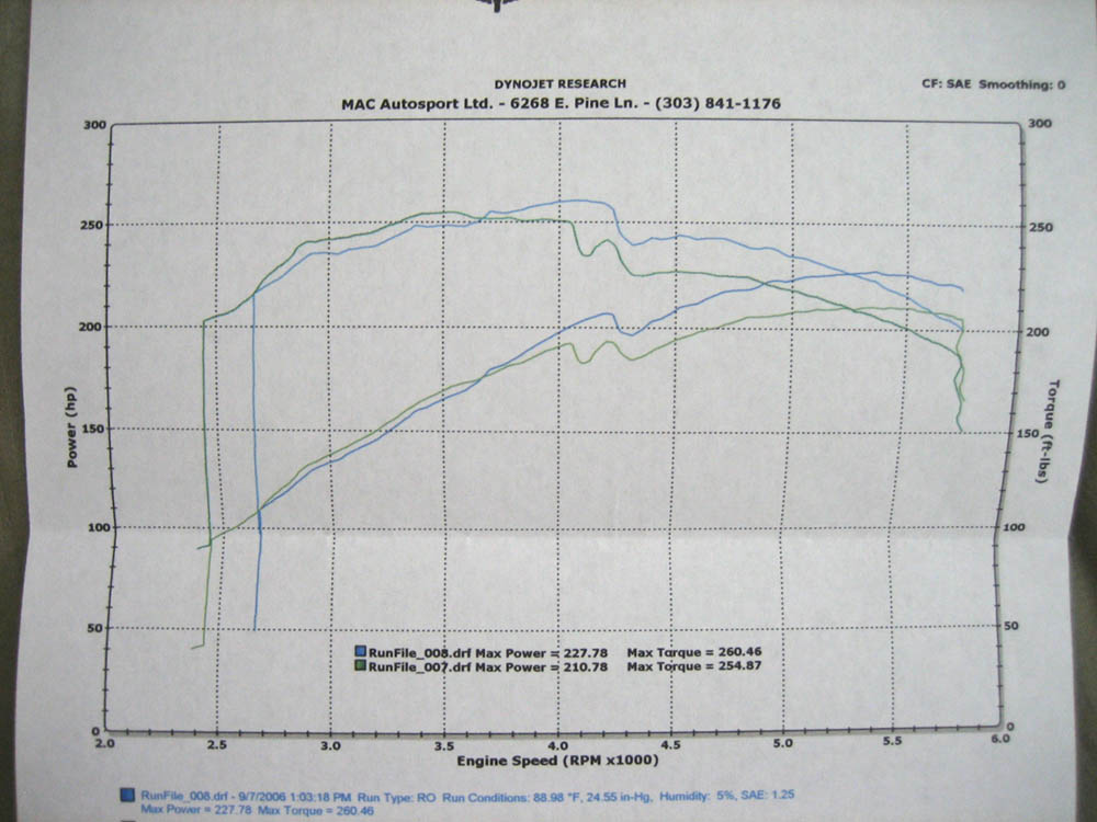

OK, well finally I got the Split Sec PCU installed and tuned. After spending 2 hours on the dyno tuning here are the results. But first, I promised to release the results of the Volant CAI. This run was done with the stock map running in the PCU before we even started tuning. AFR's were right at 11.8:1, even though the graph I posted below doesn't show it. How about 17 AWHP?? I think that settles that:
Volant CAI Dyno Proven HP:
All the gains are above 3700 rpms, though, and you actually lost power below 3700, which is where the engine is during a majority of the driving. Not an acceptable trade off to me, but if all you're after is peak numbers then congrats!

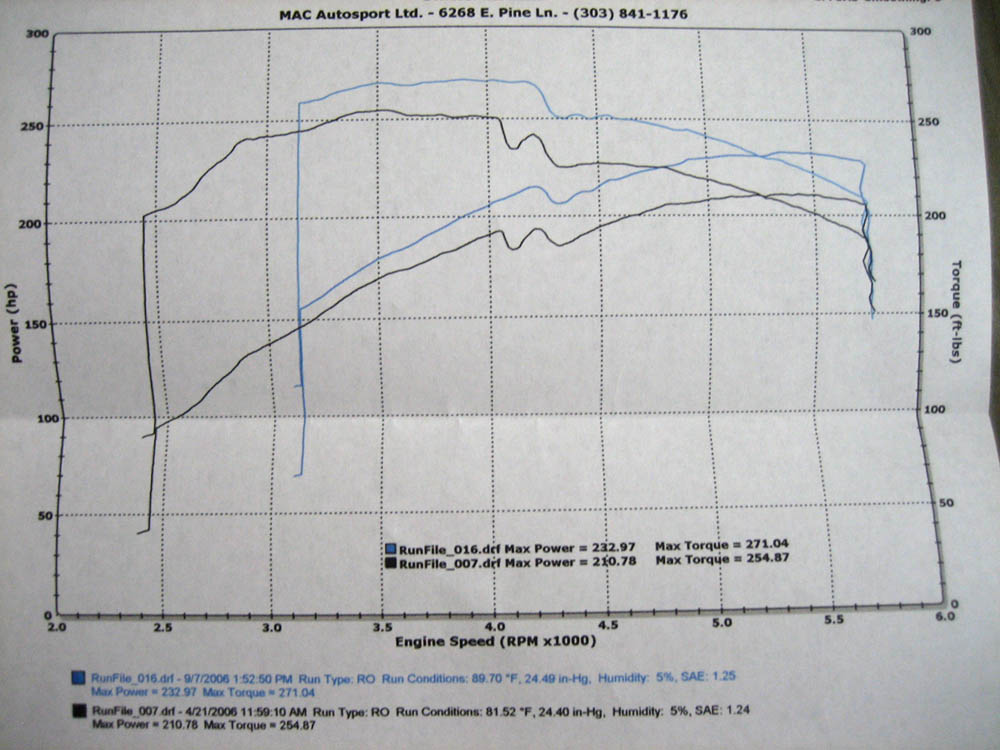

OK, now for the results of the Split Sec PSC1-001 performance control module. We threw it on and put it on the dyno and realized anywhere from 5-10 AWHP, with alot of the runs being around 8 AWHP. We tuned from 11.8:1 AFR and leaned up to about 12.9-13:1. At one point we were around 14:1 and the power was down a bit and the torque was up alot, as much as 270 ft-lbs when it was that lean. As far as what I got, I'd say its about 8 AWHP, which is exactly what I expected. The dyno sheet says about 5 AWHP over the intake, but that was after about 10 dyno pulls in a row, it was starting to get pretty hot in there, and the cooling fan was engaged too. So anywhere from 5-8 AWHP.
Comparison - Just exhaust vs. Intake/Exhaust/Tune:

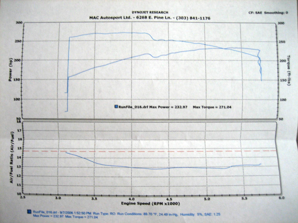

Here is a shot of the final pull with the final map - 233 AWHP and 271 AWTQ. That translates to about 300 crank HP with a 21% driveline loss. Not bad.
OK, first off, with the intake I might have lost negligible power below 3700 rpms where less power is being made, true, but if you look at the graph where I compare just exhaust to intake/exhaust/tune you can see I made power everywhere in the rpm band. This is because the engine needed to be tuned to account for the different flow characteristics of the intake and exhaust. I'm not just going for peak HP, I like low end torque and power too, and if you look at the graph you can see it improved imensely. Secondly, after the tune the engine is much more responsive at all rpms. This is why I recommend the tune with the intake/exhaust. Without it, you still gain peak power but you may lose some low end, however little it may be. Before the tune I never felt like I lost any power by adding the intake.
Let me re-iterate; the engine feels much more responsive throughout the rpm range and pulls harder to redline, which I feel IS and acceptible trade off, make of it what you will, but I'm happy in the way it drives and the gains it made...
