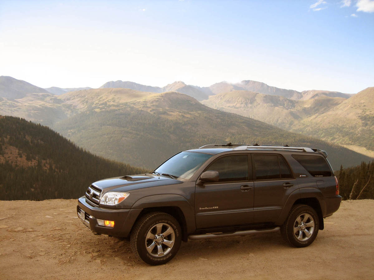

Check out the latest pic of the Runner, taken atop Loveland Pass last friday....
