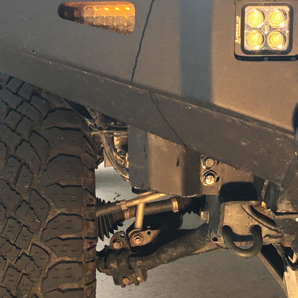

here is Hefty Fabworks offering. you can clearly see how exposed the washer bottle is (several other brands hang it out there even more), wouldn't take much to get a stick up in there while off road

This picture does not depict the sides protectors that come with the bumper, I guess the owner didn't instal them
I'm almost done with my Relentless Fab bumper for my 4th gen and planning on some type of winch bumper for my 5th gen as well. In both cases, I think I'm going to fab my own washer bottle protection instead of relocating it because I'm also planning on going with a second battery and on-board air setup. If I knock a hole in it after that, then I will figure out how/where to relocate it.

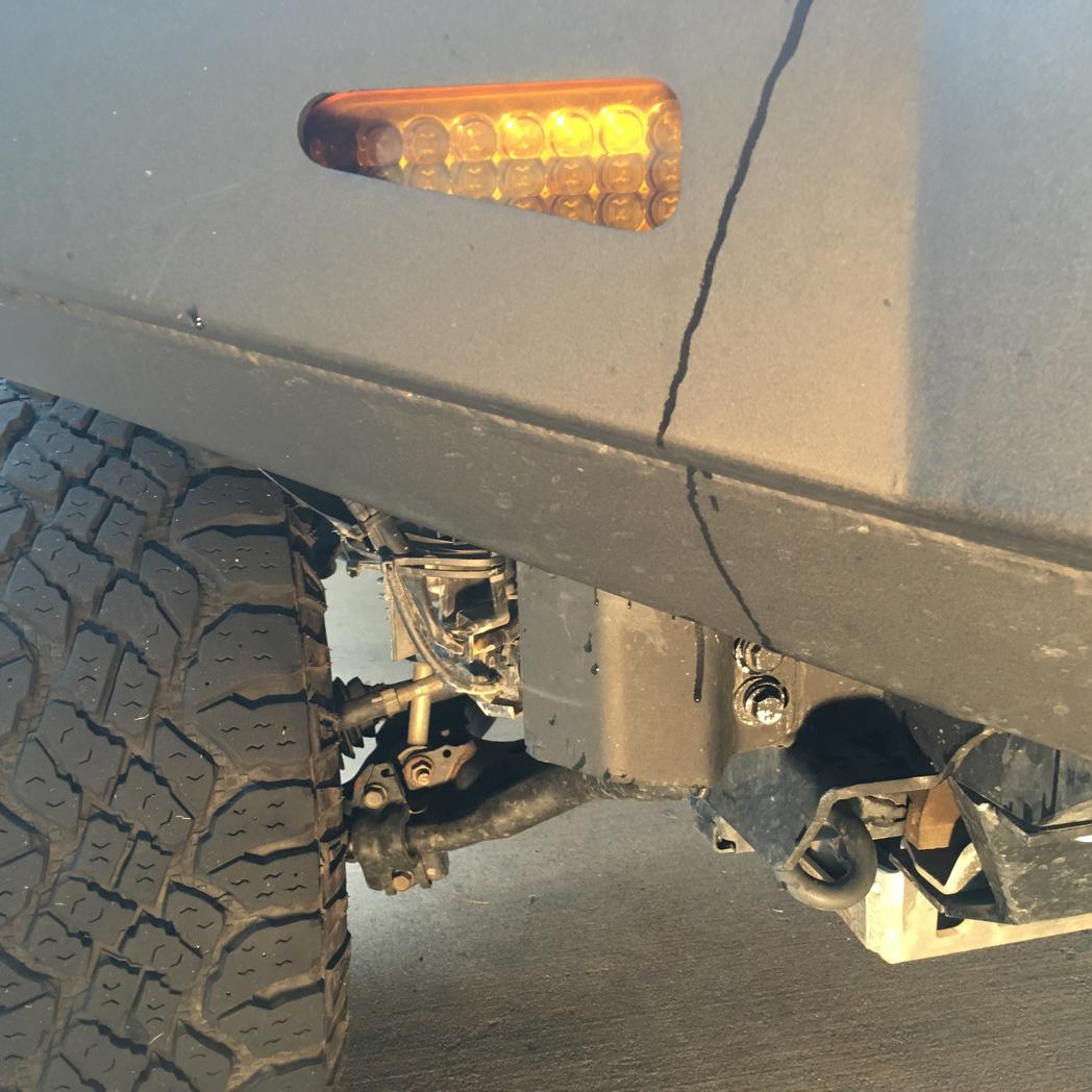

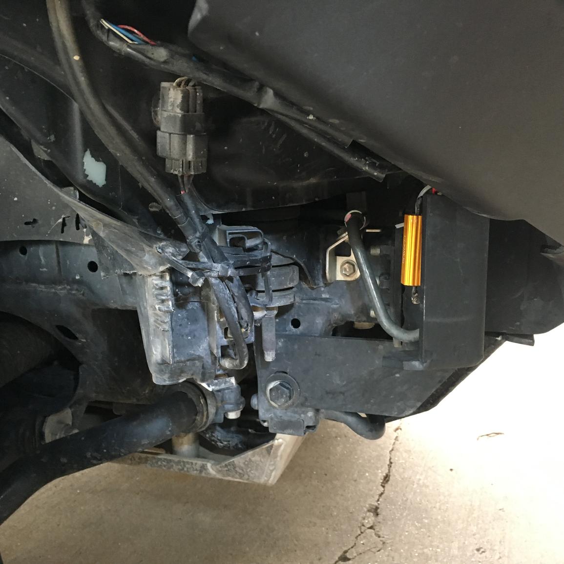

The Hefty Fab guard is just ok. It still leaves about 3 inches of the washer bottle assembly exposed from the front and does nothing about side contact. I attached a few straight on pics of mine to illicit my point. It seems that on the Hefty bumper it would be fairly easy to make a larger bolt on guard to resolve the situation. Maybe Chris would consider making one. (Chris says he's never hit his and neither have I, and to the best of my knowledge neither has anyone else, so maybe solving a problem that doesn't need solved?)

can't tell from your photos here guys, but does the Hefty guard wrap underneath as well, or does it just cover the front and sides? I'm thinking I may need to get a break and start bending some metal
Yes and no. It does wrap under but not below the washer bottle assembly. It's actually protecting a metal tube on both sides of the truck that I unfortunately can't identify :crybaby:
that is a hard line which goes to the AC condenser panel in front of the radiator

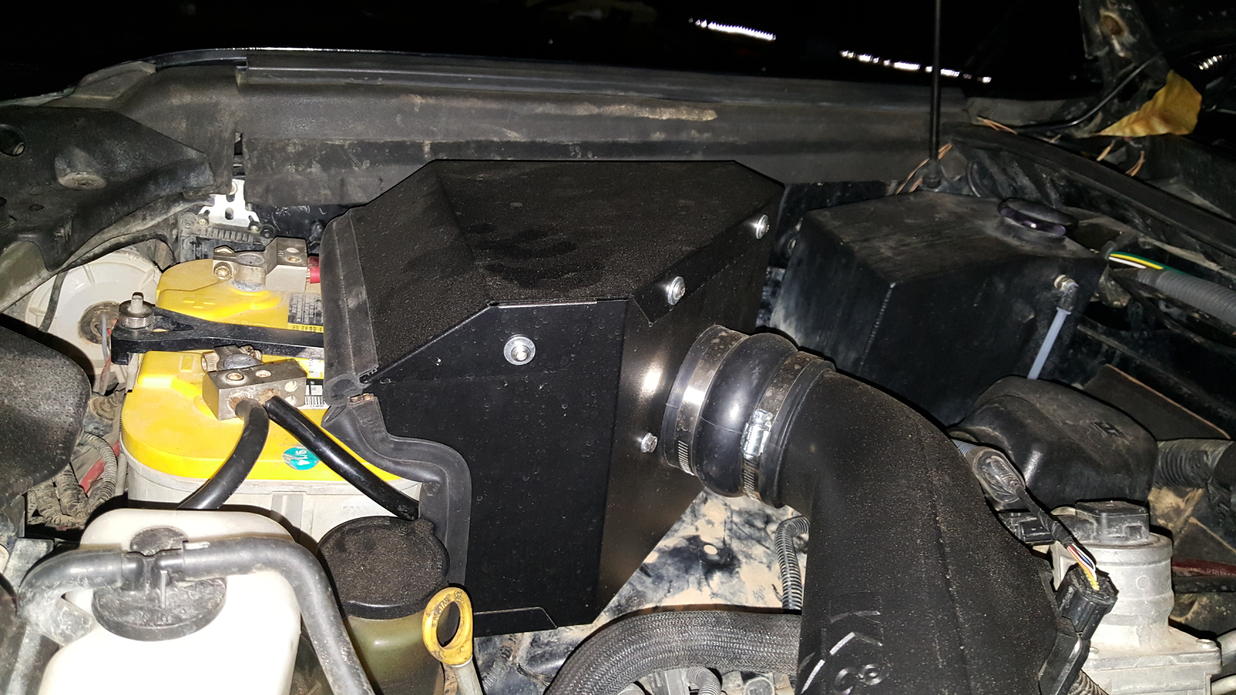

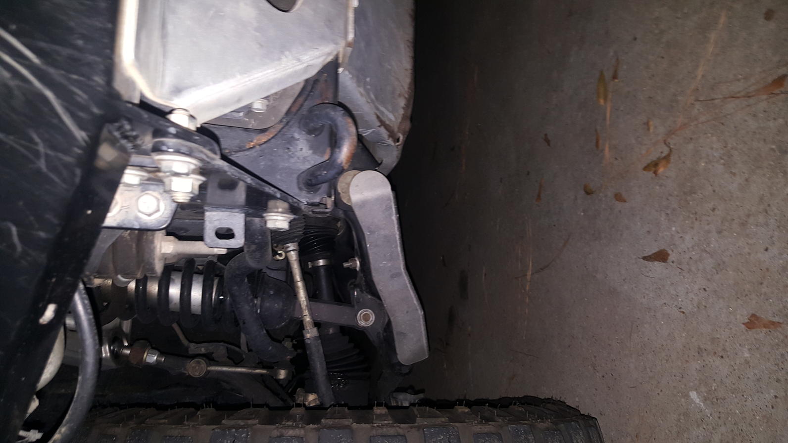

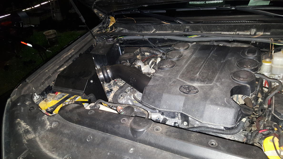

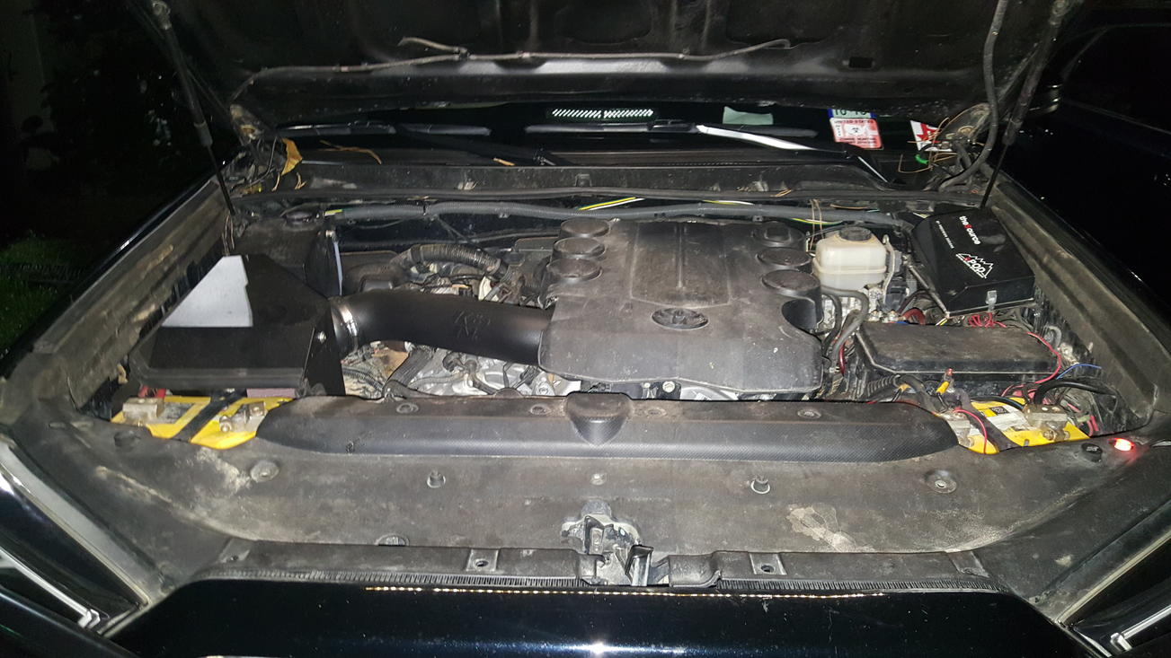

I took some quick cell phone pics last night.....I am utilizing Shrockworks dual battery tray as well as their water bottle relocation kit ( the replacement bottle is actually metal)
......and a K&N CAI

Not an option for me unfortunately, not without relocating my compressor to the passenger compartment anyway.
Also, why is your intake eating that poor, defenceless yellow top?
