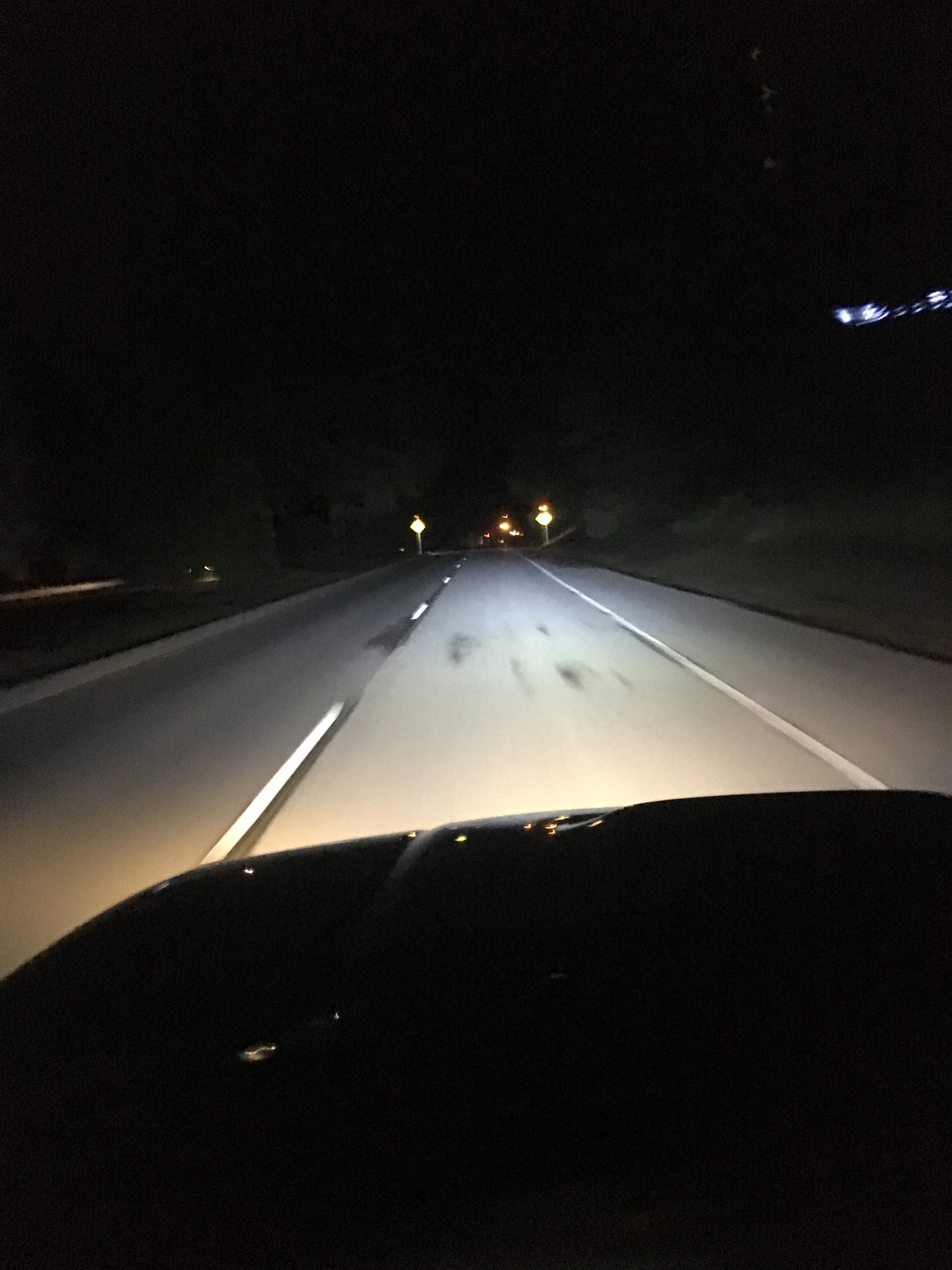

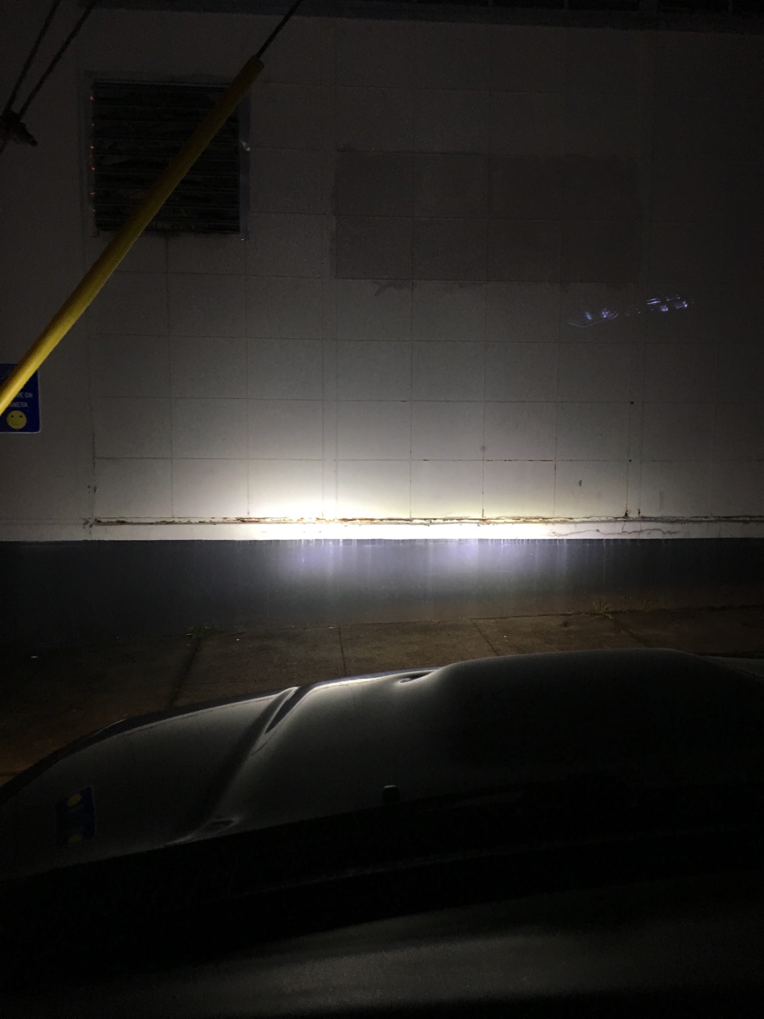

Headlight LED swap
February 8, 2017
I wanted to try out some LED headlights. Picked up some Auxbeam F-series H4s on Amazon for $55. It's warming up here in Chicago, I was not concerned about the lights not running hot enough to melt snow/ice on the lens. Mostly I wanted to just try LEDs—halos may be in my future, but I like the LED platform and wanted to start there.
The linchpin with LED headlights is supposedly the cooling fan—the lights are only as reliable as the fan. So, we will see how long these run. They seem to be well made, and have fairly good reviews.

Low beams at approximately 15 feet
High beams at approximately 15 feet

Whats your feedback on the bulbs? Any blinding problems?
So far so good—I've had great feedback, the low beams hold a really nice line and the brights do their job too :)
Really the question now is time—how long will they last?
Nice! I just got a cheaper set from eBay not much of a bright option but they're pretty darn bright. Feels wrong to have them so bright haha.
