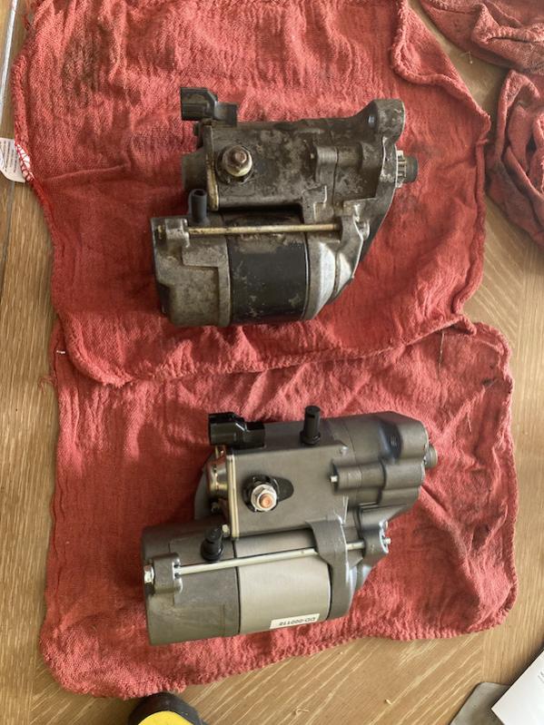

Pretty sure 1.4k is for manual transmissions while 1.8kis for autoboxes.
add to that the 1.8 is about an 1.25" longer, and DOES work in place of the 1.4 on a manual trans.
i had taken a pic of them side by side when i swapped them, but that HD has long since died.

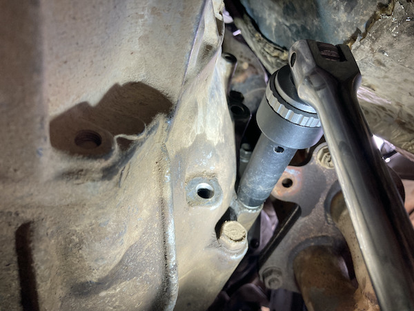

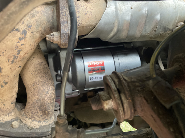

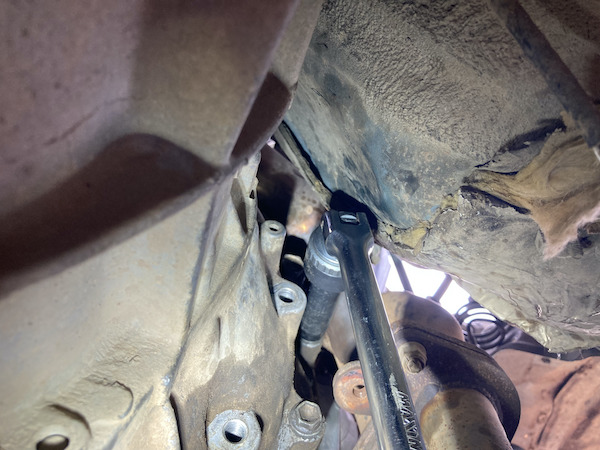

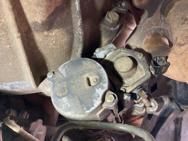

Here's a pic of both sizes if anyone is curious. I did the starter on my 97 5-speed SR5 4WD a few weeks ago and replaced the 1.4 with a 1.8kw.
I didn't have to go thru the wheel well, like most people have described doing. It came out through the space above the steering rack - I had to flip it around first, and it was still pretty awkward, but seemed easier (and less scary) than squeezing it past the brake lines through the wheel well. I did undo the brake line bolts so I could get my hand in there to move it around.
I was also able to get a socket wrench (and later, a torque wrench) right onto the starter bolts without any extensions.
End result: a shitty aftermarket 1.4kw starter came out...a new (reman) 1.8kw Denso went in. I was a bit concerned that the bigger one wouldn't fit - I couldn't figure out which size mine originally had. It's a manual, and it seems like those got the 1.4kw at the factory, but mine was also sold in Canada and as far as I can tell had the cold weather package (meaning the 1.8kw starter). Turned out I had a 1.4 in there, but it was definitely not the original.
I don't know if this was easier because I have a standard rather than an automatic, just wanted to share that it is possible this way!
