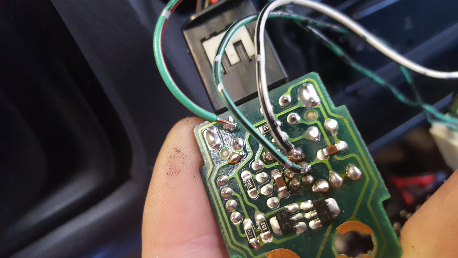

I got most of the wiring figured out for the bezel swap, but just wanted to confirm the somewhat magical defogger IC mod (since I have no schematic for that part).
Is this the correct way to do it:
As opposed to this, which apparently did not work:
Pics hosted on photobucket arent showing [emoji849]
And yeah, I can't imagine that 3-wire method would work. I used the 6-wire method in the pic above, and mine worked perfectly. Light lit up when active and everything. Worked like it came from the factory like that [emoji1360]
