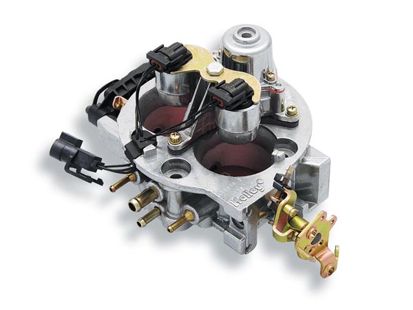

Being a 1994, I doubt it has a carburetor. It may look like one but it is called Throttle-body injection (TBI).
