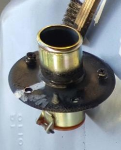

There is a flap in the fill neck flange on the tank. See pic. That flap could be stuck shut or blocked by something.
