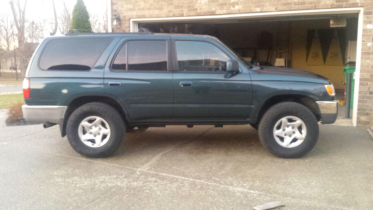

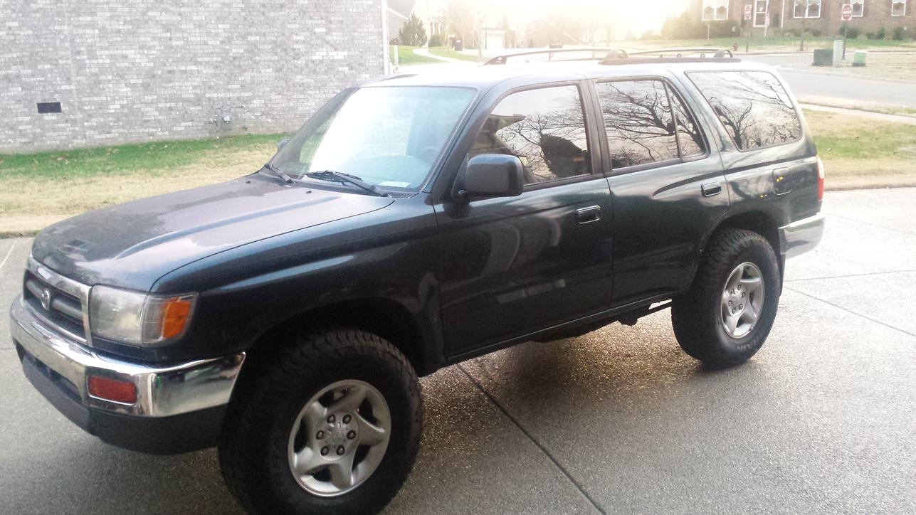

So after XMAS I will be painting my 96 SR5 2WD in Raptor liner. I will be posting updates on this thread as I go so that if someone is on the fence about that stuff they can see the end result here.
I am looking for a few things for when this is done.
1) I want to change the interior from the blue/gray to tan. I am keeping an eye out at the local scrap yards. So if anyone has insight where I can get good condition seats at a great price let me know.
2) I am looking at fog lights for the top of the truck, I am hoping to do 4 hella style lights instead of a light bar. So if anyone has old ones laying around they want to sell hit me up. Or if you have pictures of one so I can see what it would look like that would be great.
3) Want to find TRD black rims at a budget price so any info would be helpful
4) I am selling the running boards that I just took off so keep an eye on the for sale page as I will take pictures and post them later today.

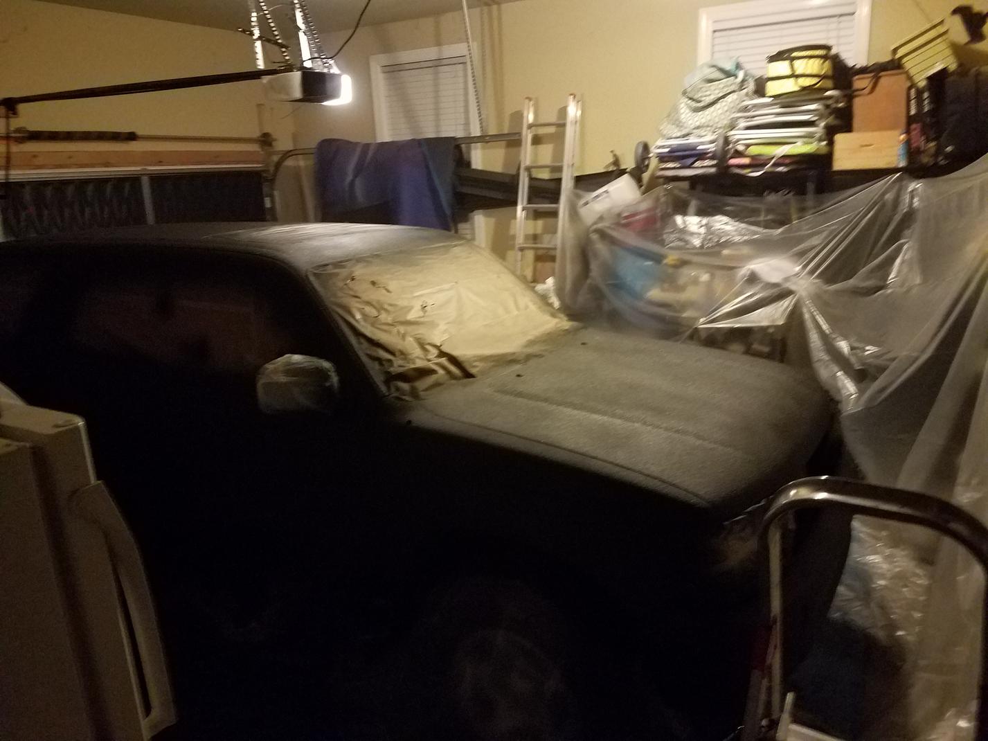

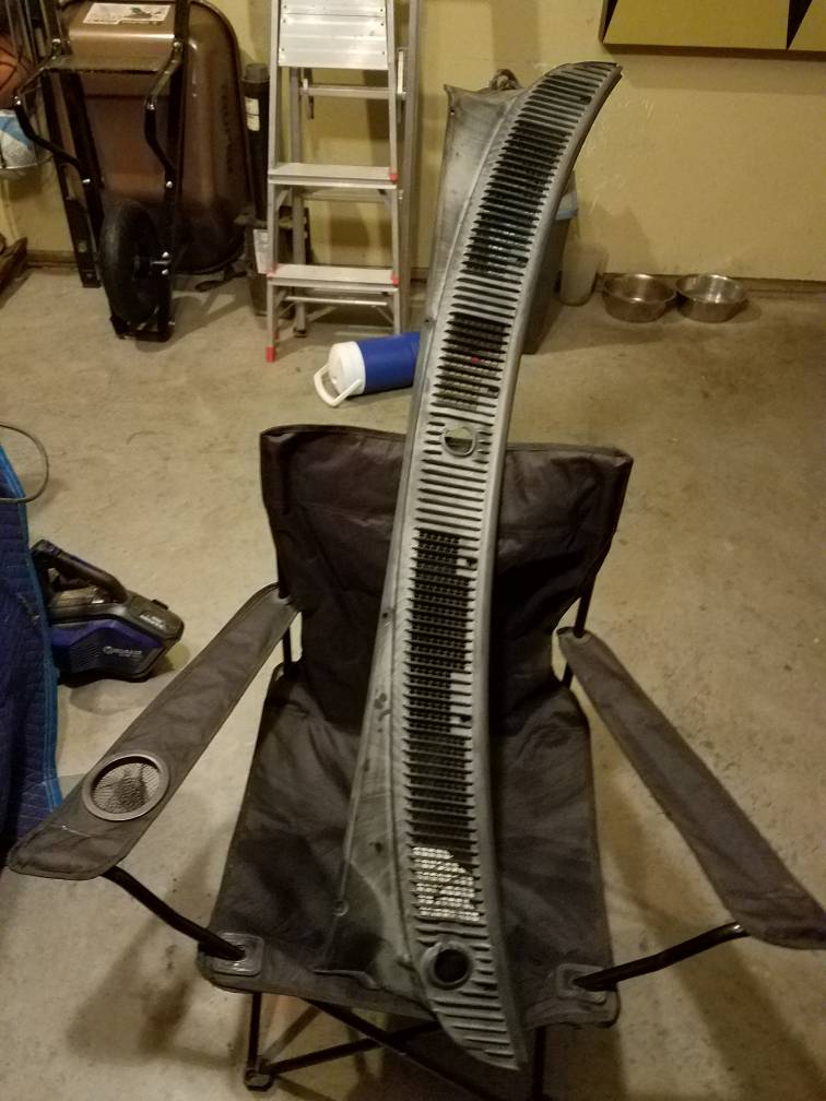

So got a few of the little miscellaneous pieces off the truck today since I had some downtime. Getting all the accessory stuff painted flat black before doing Raptor liner after Christmas.
I sanded and used etching primer on all metal pieces and I sanded the plastic. On the metal Parts I have four light coats of primer. And so far there are six light coats of flat black.
Finally got all the fumes out of the garage and the heater on so they should be dry to handle tomorrow and I will get the windshield wipers back on but not going to put the emblems on until I get the truck sanded and ready for Raptor liner.
And I got my helper who enjoys his TV breaks between coats
Sent from my SM-G930V using Tapatalk
Wiper arms and grill under windshield repainted and finished curing just in time. Thank goodness for insulated garage door and electric heaters.
The roof rack comes off when it quits raining to be painted.
Next the grill gets painted, decided to do bumpers in Raptor Liner as I bought the 6 liter package and after talking to my friend who is a professional painter and did a Tacoma +bed with 5L, that's enough for 2 good coats plus an extra liter left over.
Also, for anyone who plans to do this also, don't remove the badges, I should have painted them on the truck the day before doing the raptor liner. Now I have to clean all the residue and reapply new adhesive.
Steps I used
Sanded with 220, cleaned with grease remover. On metal parts o used the etching primer (about 5 very light coats). On top of primer about 4-5 coats of black and plastic has about 6 very light coats of black. I didn't sand after because the paint dried so smooth I didn't want to mess it up. It took half a can of primer and 1 full can of black.
