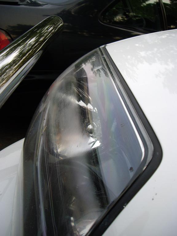

While we're on the topic. I recently blacked out my headlights on my '04 and all went well until i sealed them back up with some clear silicone. Well the nut at home depot said i didnt need a caulk gun if i was only using alittle bit, so he said i could squeeze it out of thetube by hand. Needless to say it was hard as balls to do that and i ended up making a mess. Well, with this mess, i got some extra clear silicone on the headlight fronts. No sweat, right?
Well i put everything back together and decided to take some goof-off to the headlights to get off the silicone. Turns outttttt goof-off took off the shine on the headlight, lucky I only used alittle bit or else i'd have had one entirely dim headlight and one regular one. Check it out and let me k now if you all have any suggestings as to how to restore the clearness and shine.
I'm reaaaaaaaaaallly looking forward to your thoughts/replies.

Back to the topic. Anyone have any ideas on how to restore the shine?
oh man, that sucks. I did the same thing to the dash of my jeep and nothing I tried worked. Discolored my dark grey to a light grey.... that wet sand/polish technique mentioned in one of the first posts of this thread might be your best bet at this point. (maybe first I would try toothpaste). You really have nothing to lose now.
BTW: toothpaste works great at removing dirt and grime from windshields, I do it all the time.

Easy fix, but a lot of elbow grease required. You have two good options - get yourself either plastic polish (like Mother's, for example) or a swirl remover for clear coat paint. Both contain mild abrasives that will remove the damage done by the Goof-Off and make your lenses sparkle again.
You might even want to consider using a buffer if it gets to be too much work for you. The abrasives are so mild that it will take a lot of work to get back the shine, but it will definitely work. I've used this method to restore plastic lenses that were scratched and/or yellowed. Give it a try.
