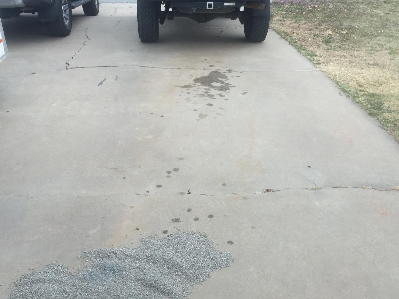

Here's what my driveway looks like over the course of the last 3 weeks. It doesn't go anywhere without marking its territory. Oddly enough, as much as it leaks, the oil level does not seem to drop. I am using high mileage oil too.

I'd go buy a large dark color doormat and put it where you park. That's not that bad, especially considering it's not enough to cause refilling between changes.
My neighbor has a doormat epoxy'd to the street where he parks his Chevy pickup. The rear main or very back of the pan is leaking and when I gave him a quote to fix it he said he'd rather buy oil and doormats, and I don't blame him.

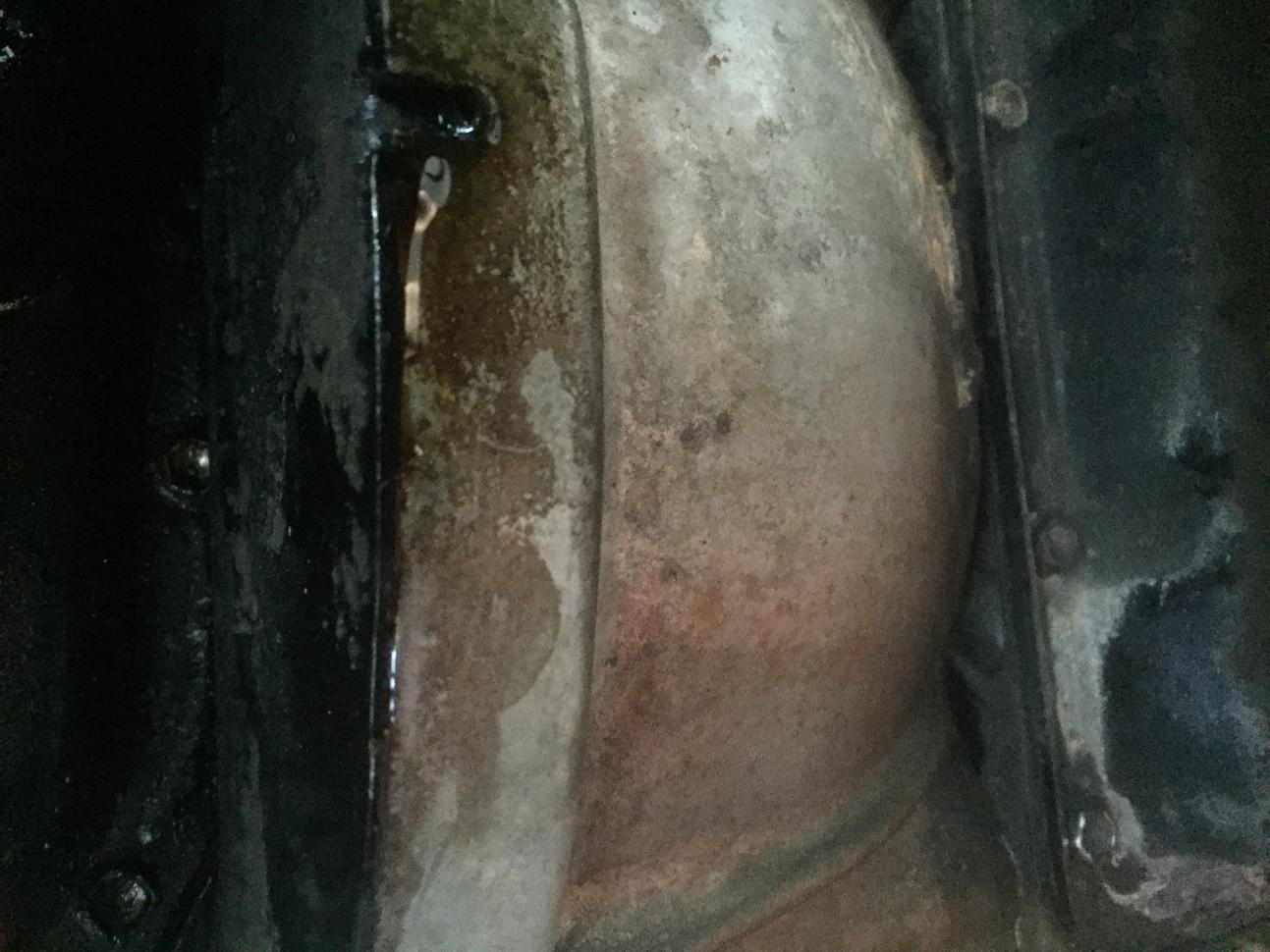

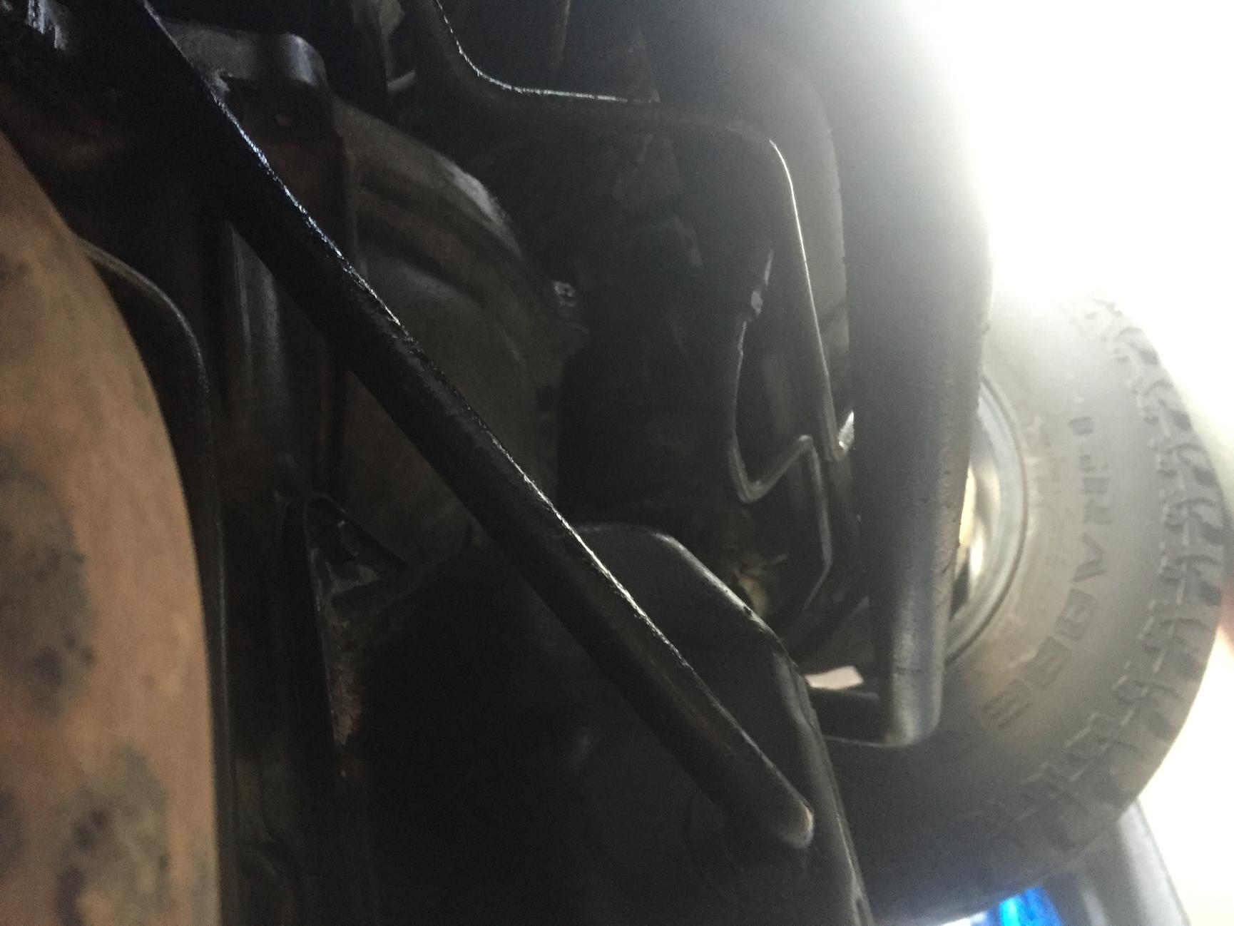

I took the advice from @Ol' Blue. I went and got some brake keen, cleaned up the underneath of the truck, dropped some dye in the oil, and went and ran the truck for about 10 minutes. Behold I have found the leak, I am not sure if it is the rear main seal or the oil pan though. I want to say it is the rear main just based on where I saw the droplet emerge via blacklight.
So the first picture is sideways, looking from the about under the passenger front door, toward the front. In the second you can see where that black piece of metal meets the tranny is where it looks like its coming out at.
However there is a little new oil on the back of the oil pan right in that area too. Should I just get the rear main done or should I pull the front diff and change the oil pan gasket?

Yeah, that could be either the rear main seal or the back of the oil pan. My money would be on the rear main, but I would remove the torque converter shield and check again before I was sure.

There should be some small diameter bolts that bolt it to the transmission's bellhousing. They may be kind of a PITA to get out, I can't remember the last time I took one off a third gen. Once you remove it, re-clean the back area of the oil pan where the leak is with brake cleaner. Start it up and watch to see if the leak starts just above the oil pan, you may need a mirror.
If it's a decent sized leak, while the engine is running, chances are it's the rear main seal. It's under oil pressure while running, and the pan gasket is not. Pan gaskets tend to "seep" more than "run or drip", especially while parked and idling.
