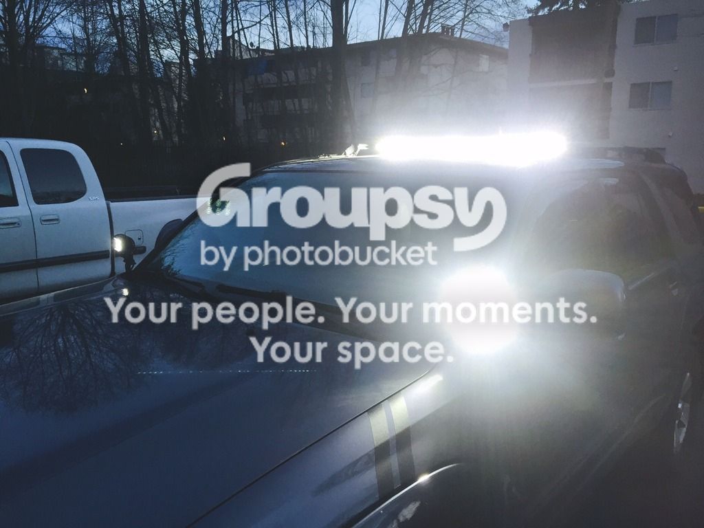

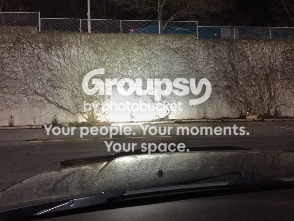

Here is what it looks like
First pic just my head lights
second pic is just the led light bar spot/flood combo

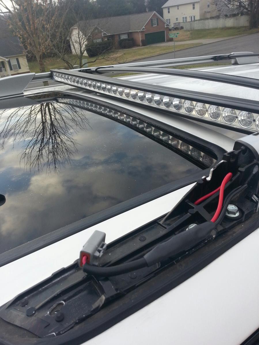

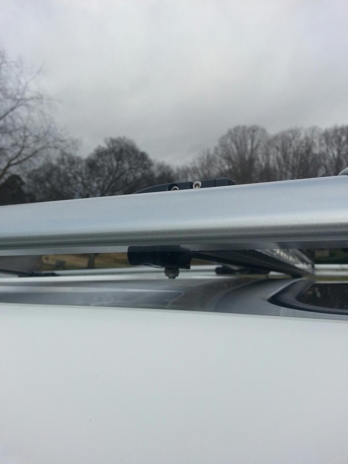

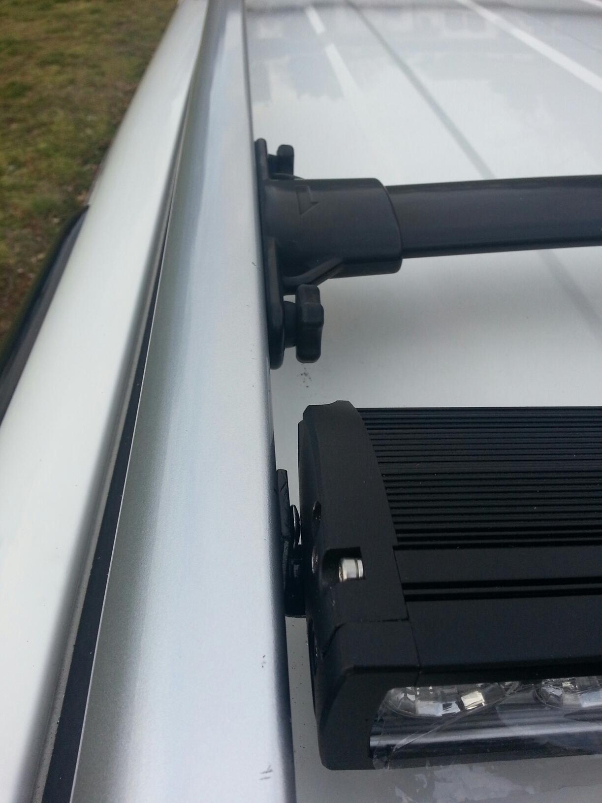

Finally got it all installed. This light is from ledbarz.com. It's a single row, 41" SX5 series, 150W. What I liked about this light was the fact that is doesn't have screw heads across the front. I had to use the bottom mount and modify the mounts by cutting them shorter. I ran the wires through the rail and down the windshield like most others.

How's the sound when driving? Any whistle?
How are you guys running the wiring down? Thats the part I'm confused on. Got my led bar in today ready to mount but can't figure out the wiring for the life of me

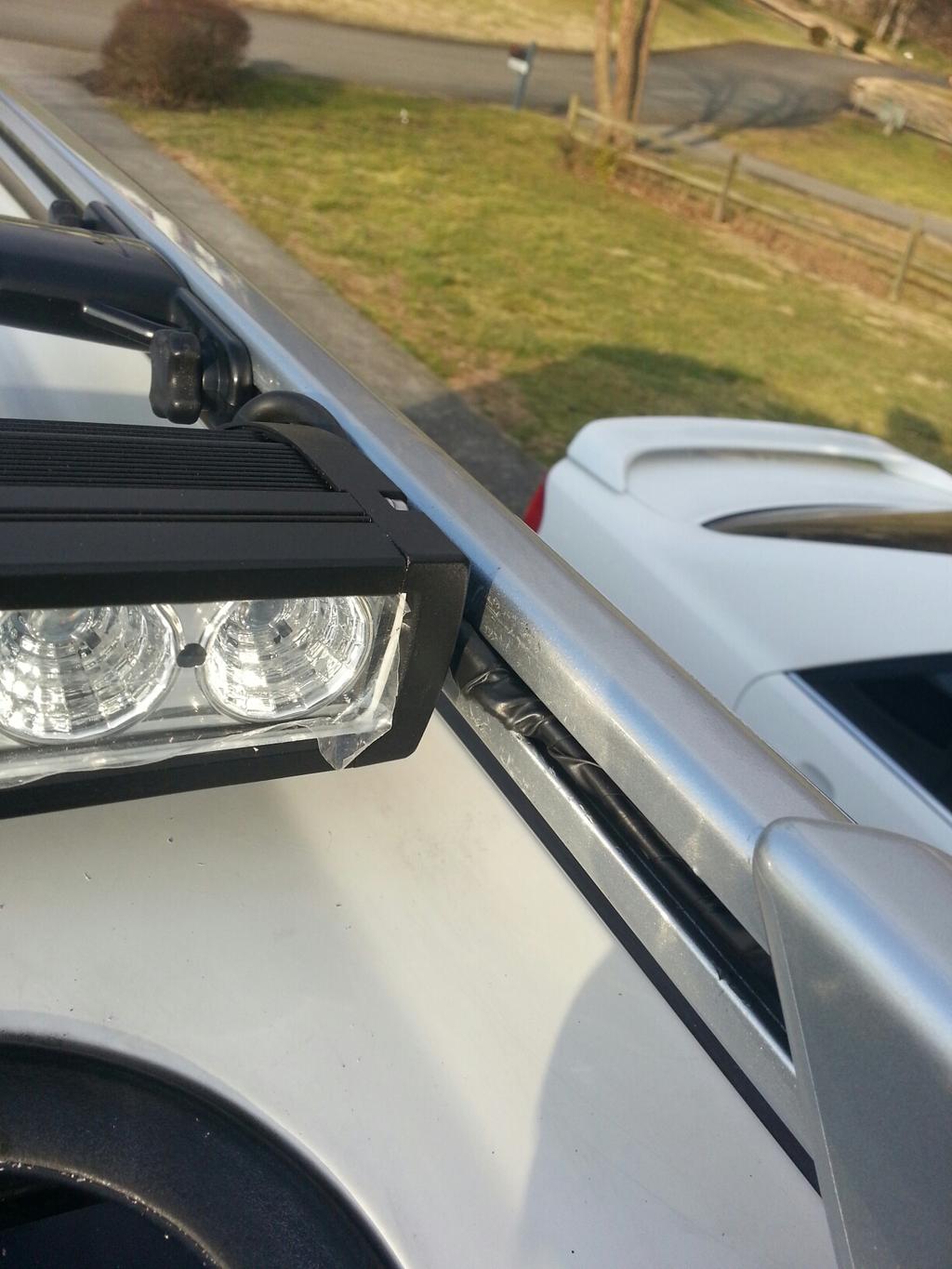

I cut the outer shield off the cable so that it was only the two wires. I ran them through the roof rack channel and under the roof rack mount and slowly worked them under the rubber trim down the windshield. There is a groove beside the windshield they will fit into.
Don't use anything sharp to push the wires under the rubber seal. I had a plastic tool used for computers, but you could probably wrap electrical tape around a screwdriver. You don't want to damage the insulation around the wire.

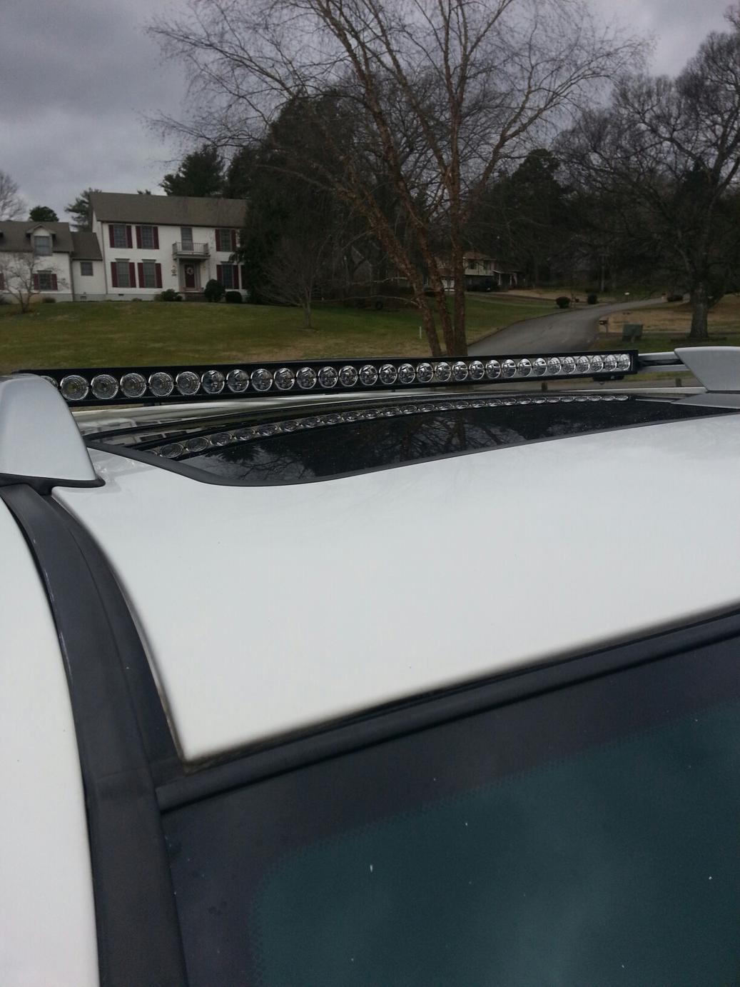

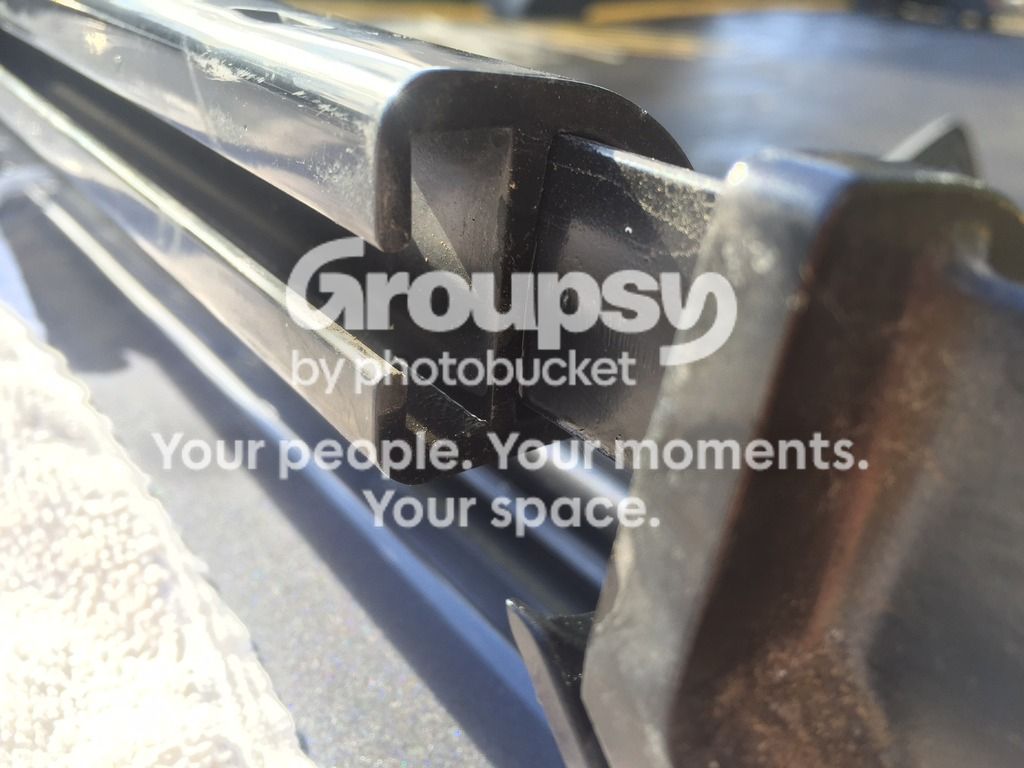

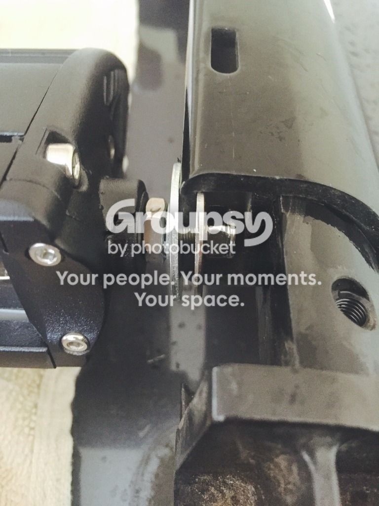

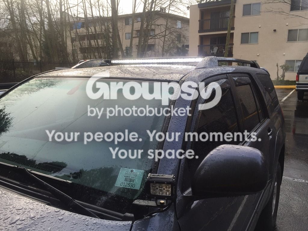

I'm loving all these "stealth bar" options you all have! I decided to have a go as well and ordered a cheap single row LED bar off Amazon. Didn't know exactly how long it was going to be, so after receiving it, I got measurements and devised this way of mounting it:

I actually thought about that way to mount also, that looks good!
Thanks, RickC! I'm diggin the look of yours too. How did you utilize your Ledbarz' bottom brackets to mount to the rail? Looks like yours is tight on space like mine.
I used L brackets from home depot. I just cut them to size that I wanted. I was wanting the light to sit evenly between the rail height wise. I also cut the mounts that came with the light to shorten them. The mounts for my light is what is used to adjust the light bar angle so I had to use them. This brand of light was too wide to use the side mounts unless I went with a setup like you are using, but I would not have the ability to adjust the angle of the light.
