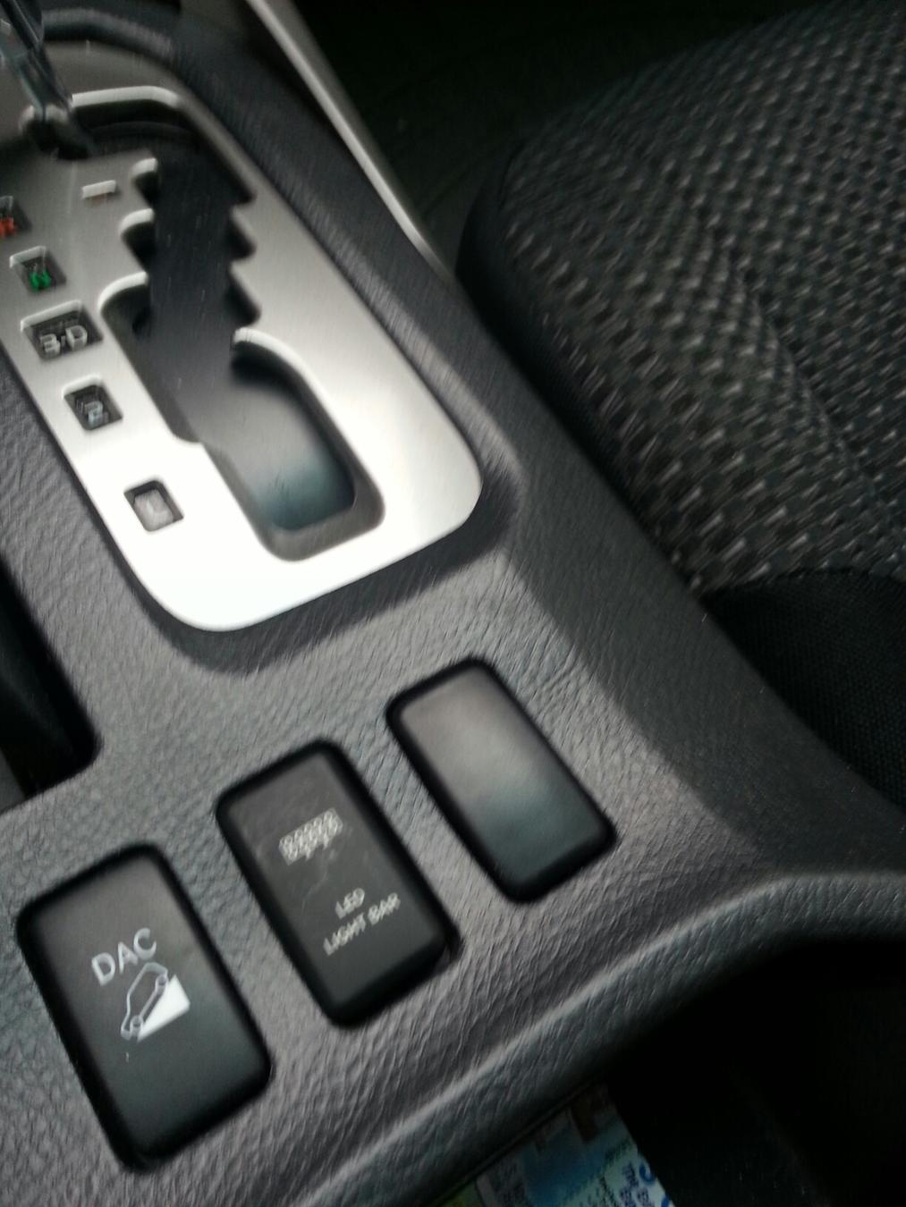

What about just wiring the switch light into the dash dimmer? I did that with my switches
http://www.toyota-4runner.org/4th-gen-t4rs/170580-overhead-6-switch-panel.html
You could also install an in line resistor to make it dimmer

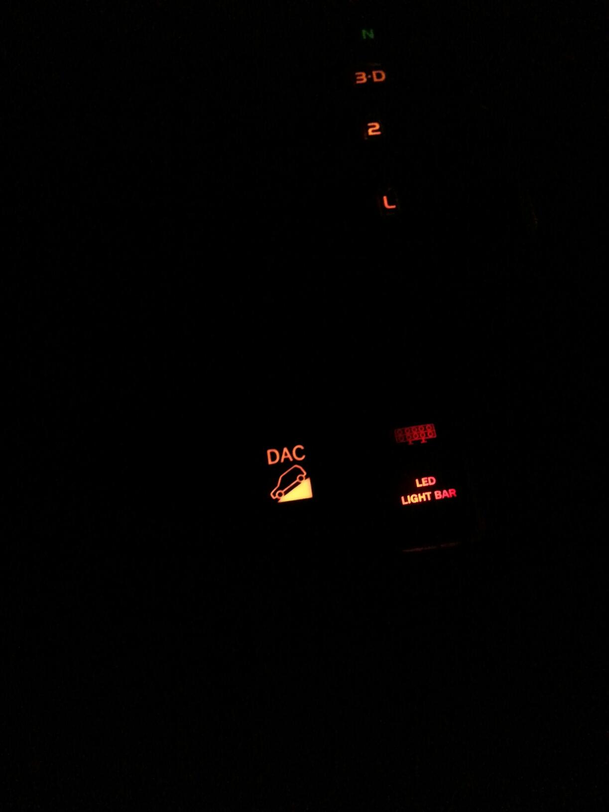

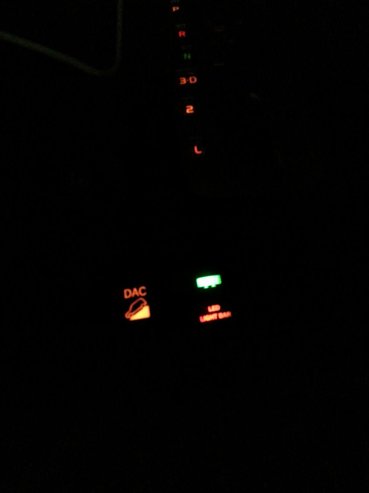

I remembered to take pics at night of the switch brightness. These are cell phone pictures, so they aren't the best, but you can see they are not over bearing with brightness. Here are two pics, one with the switch off and one with the switch on.
Yeah, that's not so bad there.

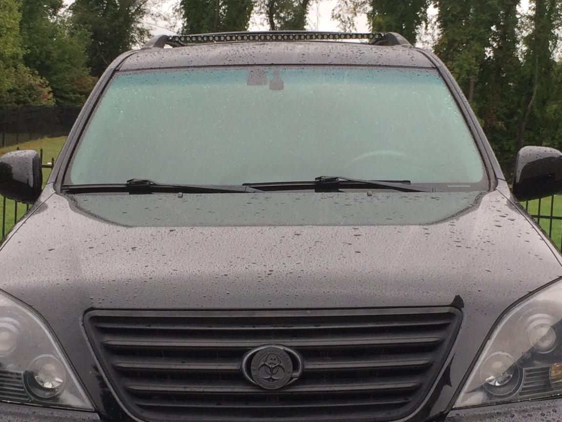

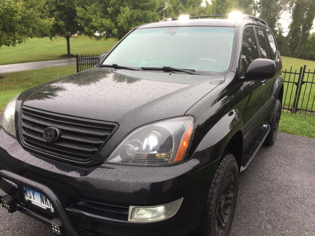

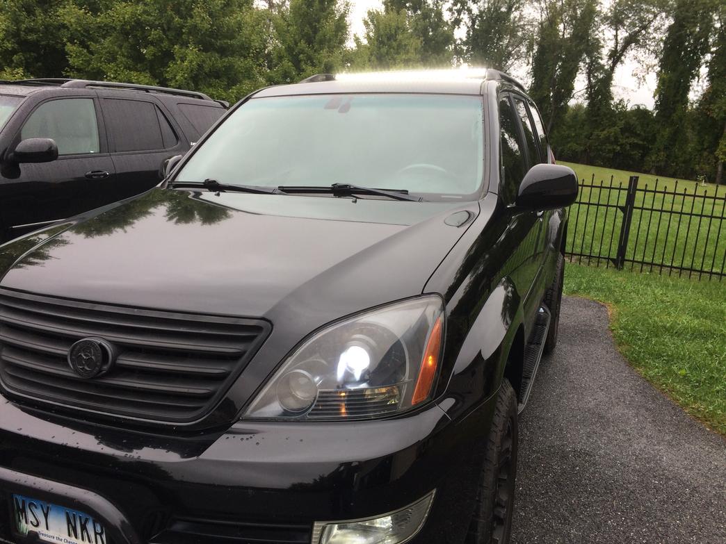

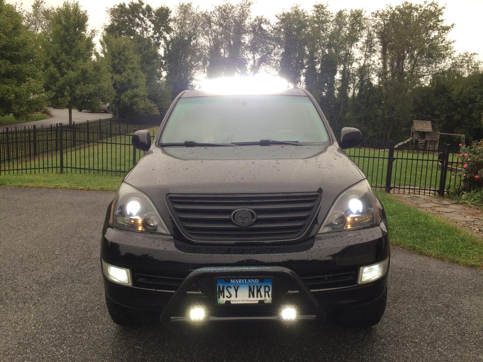

Here is my stealth bar. Thanks for the idea, I changed my two lights to s single strip.
