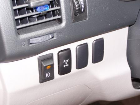

The dash switch (round rocker on-off switch w/ LED) has three spade terminals. None of terminals need a wire to come from the engine compartment to the inside. The 3 terminals on the switch are...
1) +12v (you can use an add-a-circuit to power the switch from your fuse box, see pic)
2) Ground
3) Wire that goes to the relay in order to trigger it

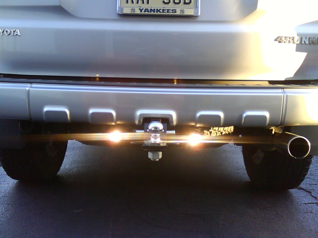

I did this as well. Very nice write up Lowpro!
I did the simplified version and used T-taps and wired it directly to the reverse wire and the ground the feed into the trailer hitch. I am not very electrically inclined, so no switch for me, but that is a nice touch.
I used the 20 led fog lamps from v-leds.com to match my led reverse bulbs. But those seem to have a wider and taller light output, I will try to check out some different angles and compare. But either way, I am pretty sure those put out much more light and have a wider and taller output than the leds.
Thanks for the write up, nice work.

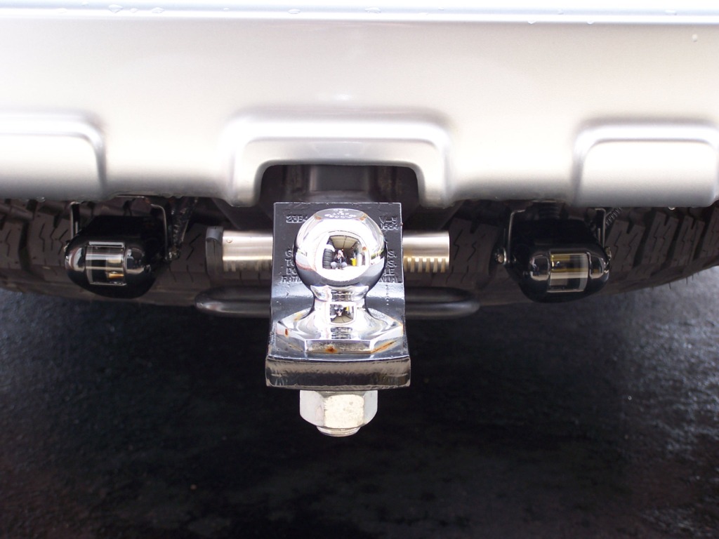

I will fersure! I got the same lights and replaced with 100 watt bulbs. I have a different tow package on my 06' so I had to mount mine farther apart and to the bumper.
