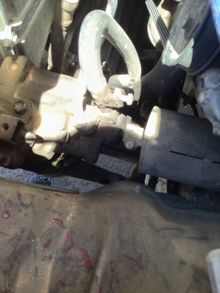

A few pics of her! It looks like its coming out of the input shaft seal. You can see the puddle on the ground next to the frame rail.

I'm not sure you're going to find anything better. Guys that run crossover steering with huge offroad tires on heavy armored-up rock crawlers use the same steering box you've got right now - I think if there was something better, they'd be using it. I think your best bet will be to rebuild the one you've got, and 200,000 miles from now rebuild it again. :)
