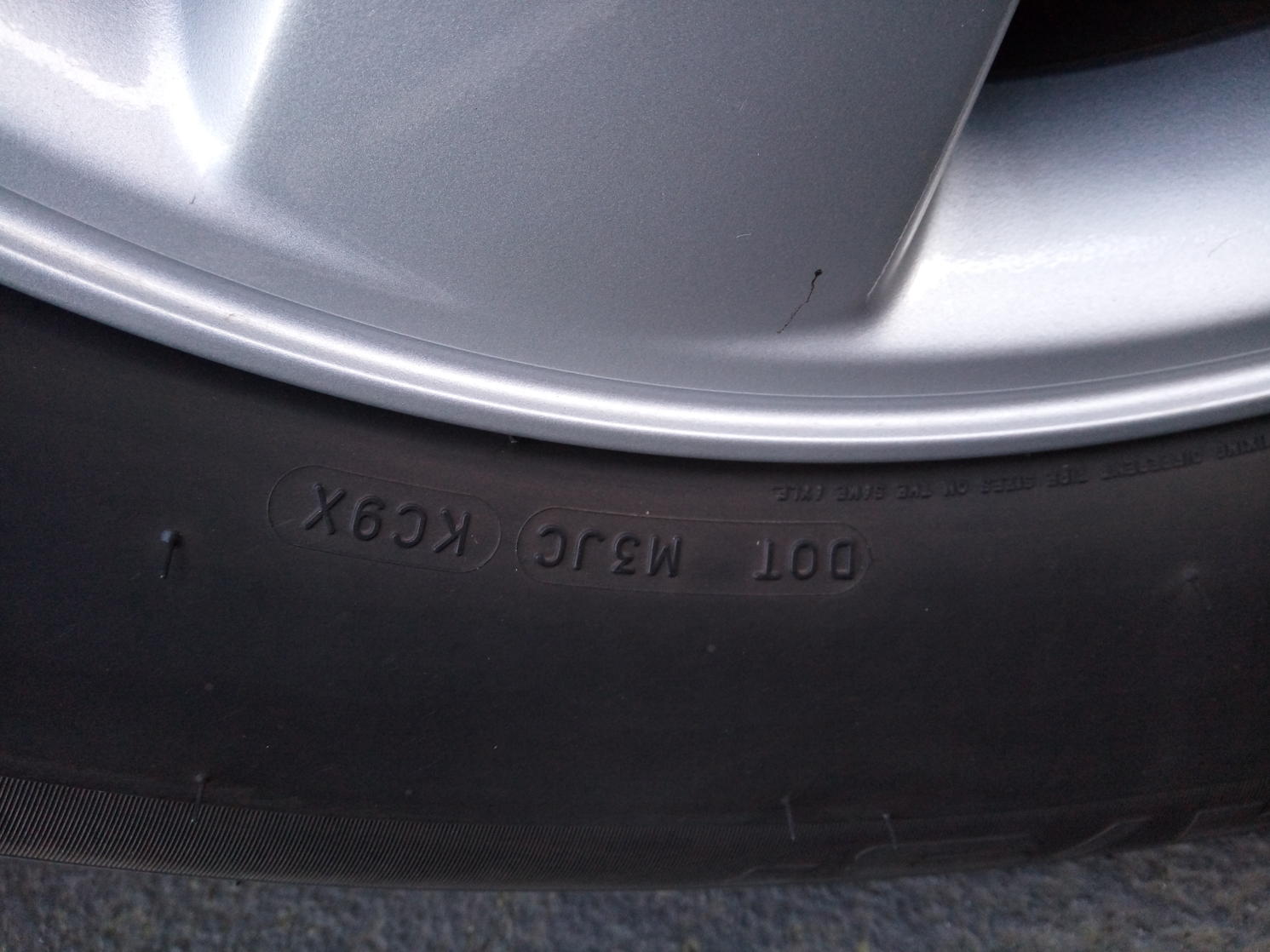

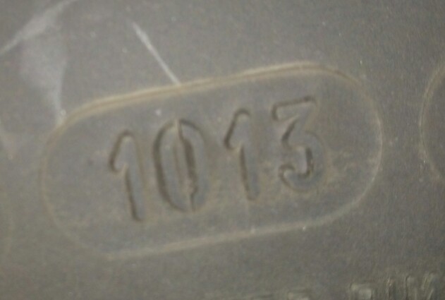

Check the other tires, or the opposite sidewall of the tire you photographed...you're looking for a 4-digit number, no letters.
Okay. Got it. It was on the inner side of the tire. Really hard to get to and see.
1013
How old before tires need to be replaced? See previous post that shows tread
