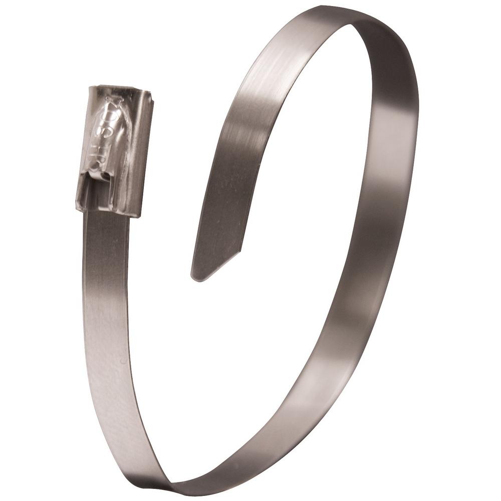

Zip ties are fine since this boot is under low stress. In fact, my aftermarket AC Delco boot kit came with zip ties.
I managed to do it with a small pair of long nose Vice Grips. I adjusted them so the unclamped position was about the distance between the unclosed hooks on the band clamp, and then squeezed the hooks together until the pliers locked. Then I tapped the little ears over with a drift and hammer.
