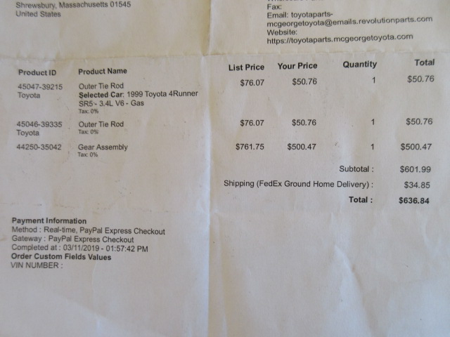

I was also at inspection fail this month due to rack. Here's my invoice from curious Mcgeorge. Ordered oem rack which includes inner tie rod ends, I also ordered the outer tie rod ends, which you should obviously do at same time.
I ended up needing both hoses also, which you can get from them.
The rack bushings I ordered Energy Suspension, They were like around $30.
Steering is much better, nice and tight.
