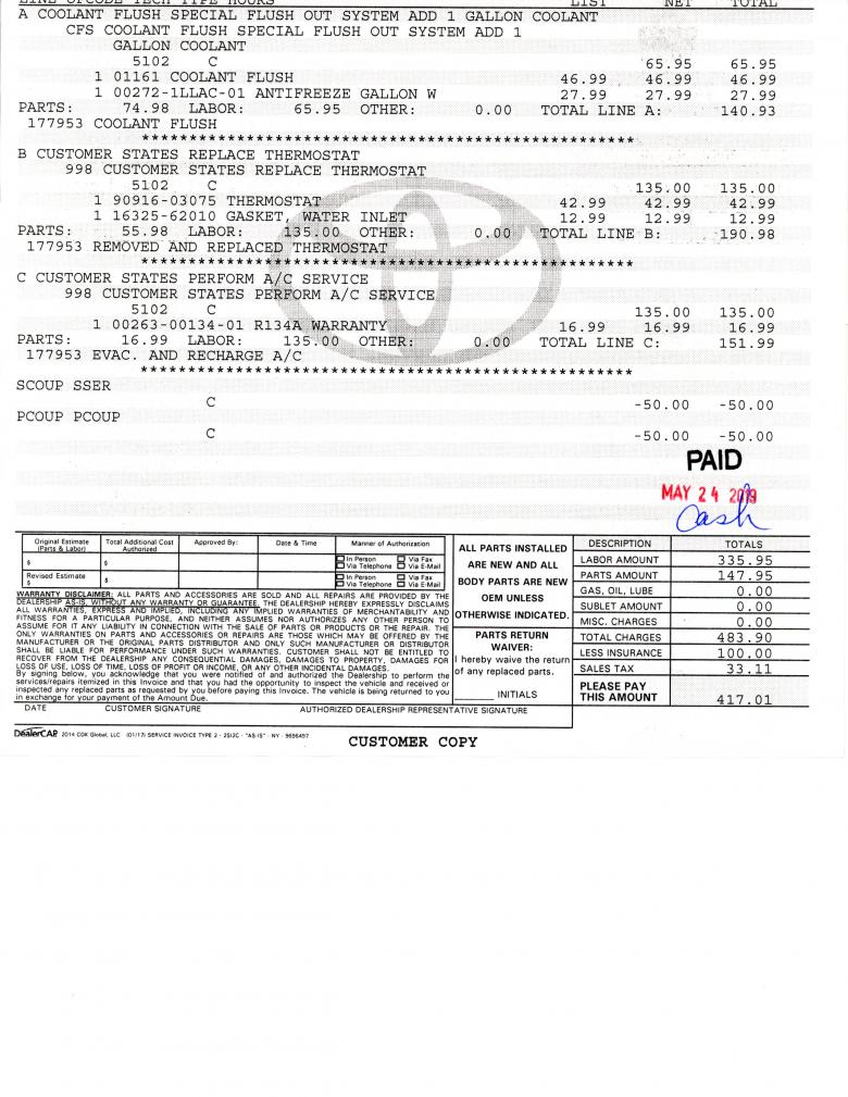

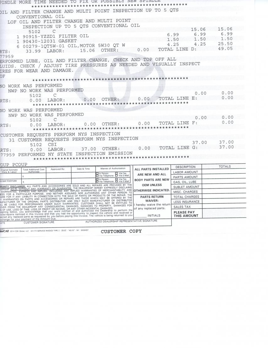

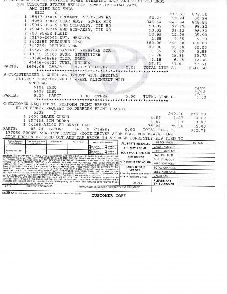

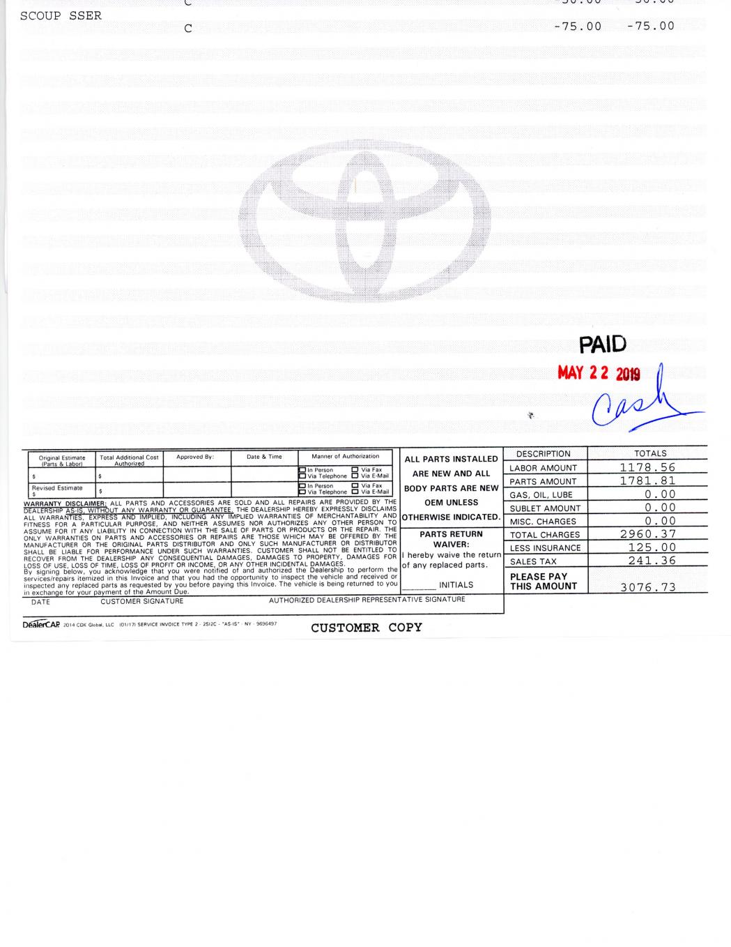

Thanks for all of the suggestions.... I had ALL the work done and this is the result.... No fluid in the driveway No strange noises and above all Peace of mind... which is worth it at ANY price. I'm good for the foreseeable future. There were some unexpected issues that added a lot on the bill.. some of the Lines need to be replaced(pressure/return) which were rusted beyond repair. Until the next crisis....
Something tells me you will be keeping this vehicle for a looong time! That's a chunk of change you laid down. Here's to another 177K!
I really like the truck.... to be fair... i'm not in a position to buy anything else so it was either spend the money or not. I'm hoping to get another 2+ years out of it.. The truck does not owe me dime one.... it's never left me stranded and it's only embarrassed me once when the wiper motor died DURING A RAIN STORM while on a first date(luckily she had a sense of humor) All it asks of me is to take care of it. I think the next thing might be less aggressive rubber..

Well, if you're happy with paying that bill, that's good because most people on this forum would be shitting their pants seeing a bill like that. They charged you $900 to replace a freaking steering rack. That is highway robbery. And of course they incredibly overcharged you for all the parts. They overcharged at least $300 just for the steering rack. $250 labor to do front brakes? Unbelievable. $65 labor to flush the coolant - They opened the drain plug on the bottom of the radiator and refilled it. $135 labor to replace a thermostat - it takes maybe 15 minutes to remove the lower radiator hose and the (3) nuts that hold the water neck onto the water pump. I think the AC service was close to being fair because it does take special tools to do this right.
Wrenching isn't for everyone and I do realize there's the situation where people live in apartments or condos with no garage space to work in. But, when you have the space and time to do your own wrenching, you can save yourself an incredible amount of money. Wrenching isn't always easy and you're bound to run into snags and get frustrated but in the end it's worth it in my opinion. You literally could have saved yourself at least $2000 doing your own work.
