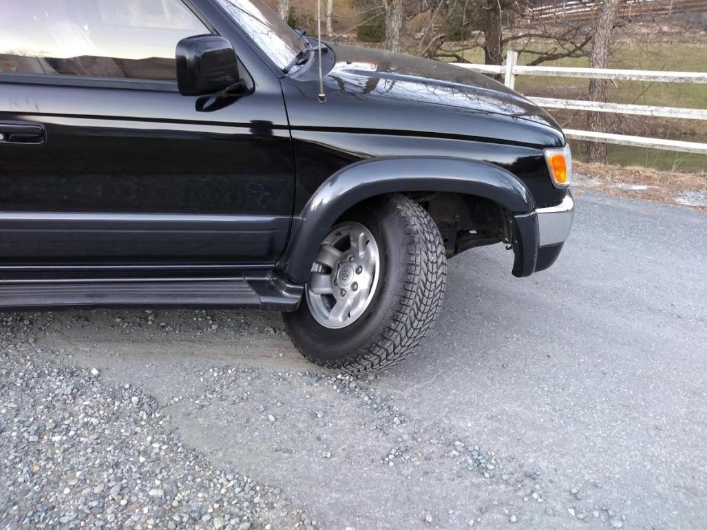

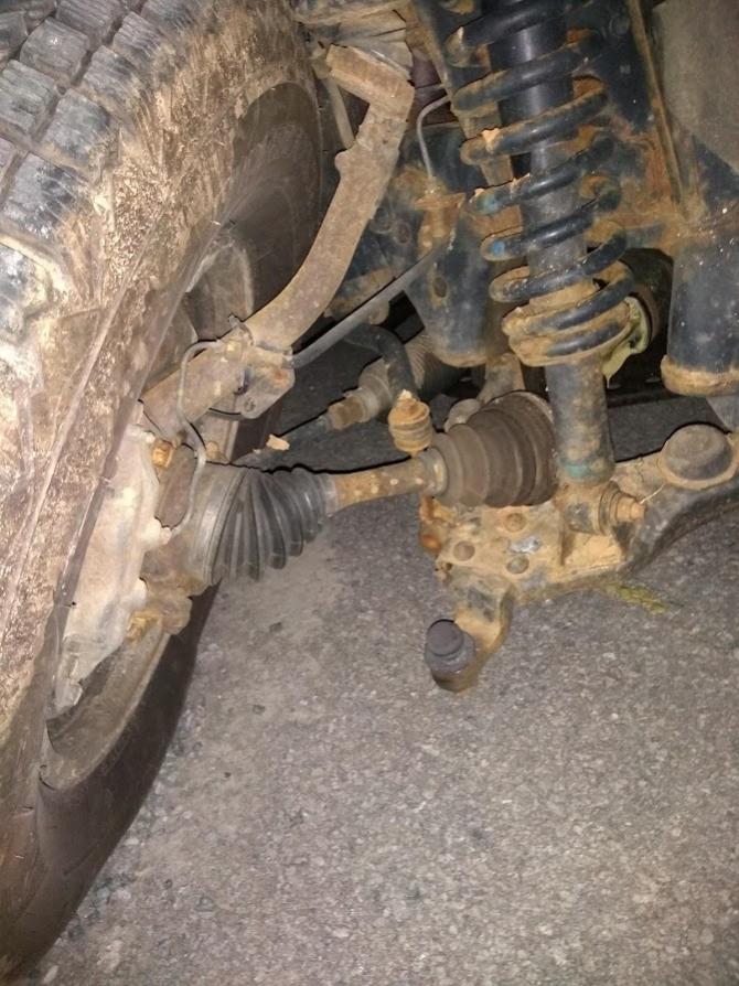

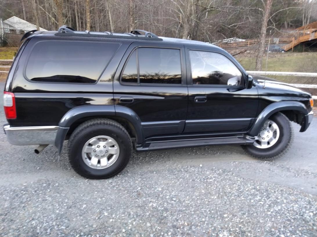

I found out why Friday morning. Luckily we were 50yrds from the house and were going 3-5mph when the ball joint failed. Nothing damaged and nobody hurt. I got it towed back into he garage and replaced both ball joints last night. I wanted to post this just in case anyone was searching for a reason as to why their steering was getting considerably tighter and their steering wheel was getting difficult to turn. I just bought the truck and the PO said he thought the rack was going out, so that's where my mind automatically went to. Hope this saves someone down the road.

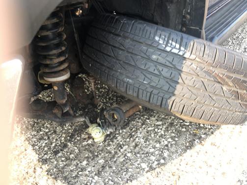

We all know these are just waiting to fail, so I'm thankful yours wasn't in a dangerous situation. It's also interesting that there wasn't any major force that caused it to come loose (speaking from experience). I knew mine needed to be replaced when I purchased it (due to the loud clicking when turning). Was saving up the money and time when I hit a pretty legit bump in the road from construction at about 30mph and just destroyed the joint and axle and rods etc.
Ended up replacing all of the ball joints in the front, tie rods, and cv joints.

When it came apart I noticed the ball and the socket were both bone dry. That ball had been spinning metal-on-metal in that socket causing the steering to be labored.
