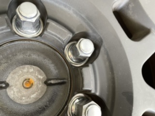

I haven’t had any acorn nuts on my 2014 or my 2021 T4Rs. There is a flat retained washer on my lug nuts to match the flat surface on the wheels.
These wheels are hub centric only.
They will not move on the hub, but always torquing sequence is a must!
