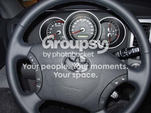

Well if your going to go to the trouble of changing the steering wheel you might as well get one with bluetooth controls...you'll want them one day
DSC04515.jpg~original
Is it easy to turn off if you have company in the car? I don't like everyone hearing my dirty conversations. ;):
I just wanted to give a special thanks to [MENTION=93994]cacoghill[/MENTION] for stepping forward and offering to trade me steering wheels. His 05 Sport has the controls and he'd rather it didn't.
After a bit of research I've found that the part numbers for the 05 are different of the 07. The controls are actually attached to the side of the airbag. We could maybe make it work if we traded the entire steering wheel, but his is leather wrapped and mine is vinyl. I wouldn't want to give up my leather one. :(
