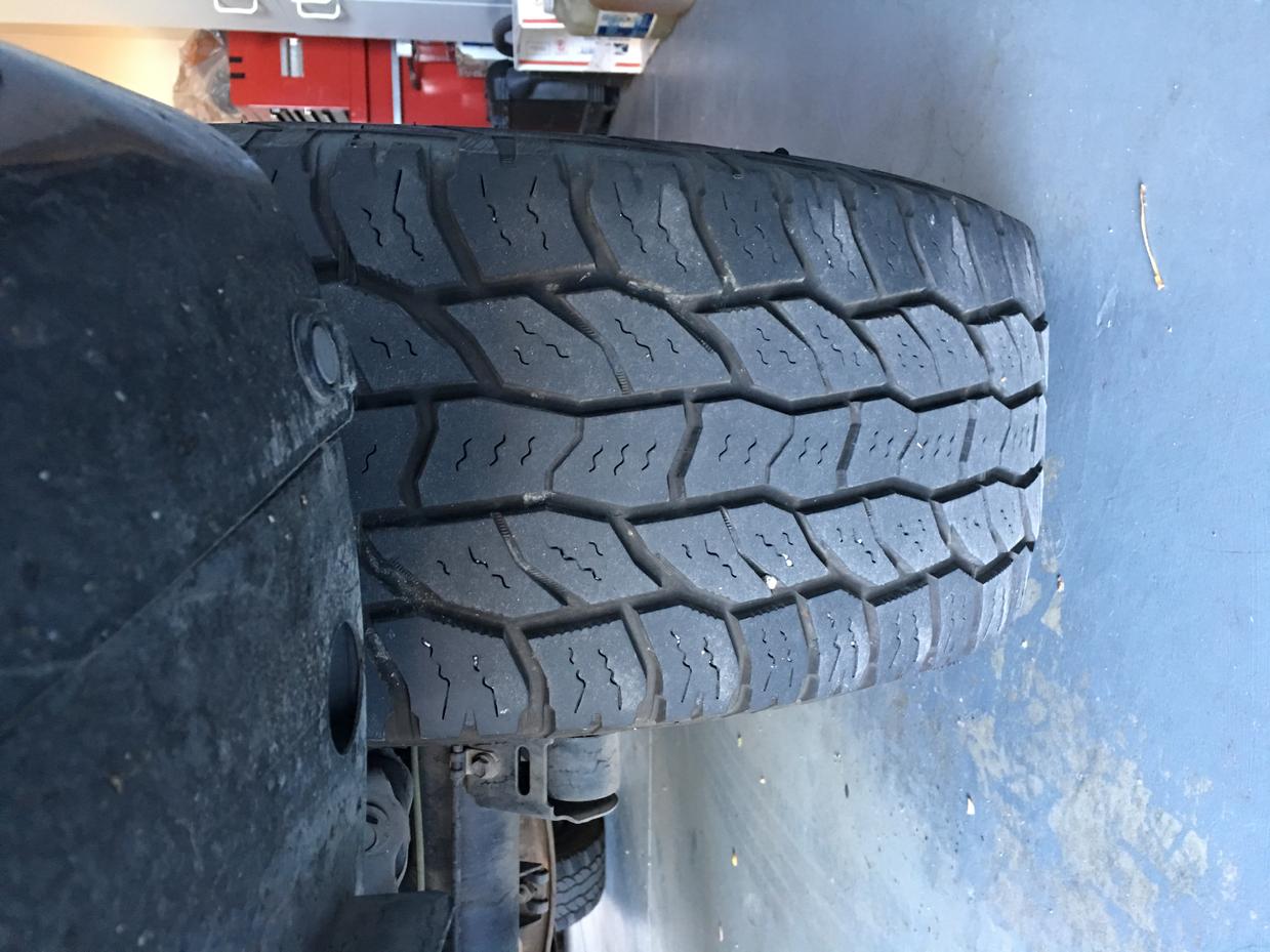

I originally voted "no" in this poll as I had no vibration issues. Since then, and since mounting some Cooper AT3s, a vibration has developed between 60-70 mph on the highway. The wheels are balanced very 5K miles when I get them rotated at my local DT (non-Hunter machine). With the AT3s, I have noticed an interesting wear coloration on the inner and outer edges tread blocks of my tires as seen in the attached picture. This pattern is uniform on all the tires, as you can see in the front tire on the left hand side (or bottom) of the pic. Has anyone else with AT3s noticed this wear pattern?
