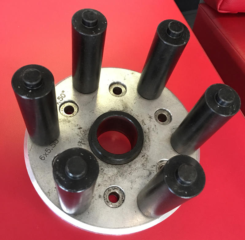

I had another America's Tire rebalance my tires a few weeks ago.
They used this lug adapter that has these special pins with a shoulder to simulate our flanged mag style lug nuts. The tech had to order these special pins because they had straight pins with a radius that look like the pins on the typical Haweka adapter.
This is the best balance I have had so far. Still some minor shimmying when the tires are cold, but mostly goes away after driving a few miles.
The ironic thing is this America's Tire did not have a fancy GSP 9700 road force balancer but they were still able to get a better balance than other shops and dealers that used a GSP 9700. They have a lower end Quickmatch balancer that can check wheel and tire runout in thousandths of a inch as opposed to a GSP 9700 than gives road force numbers in pounds.
