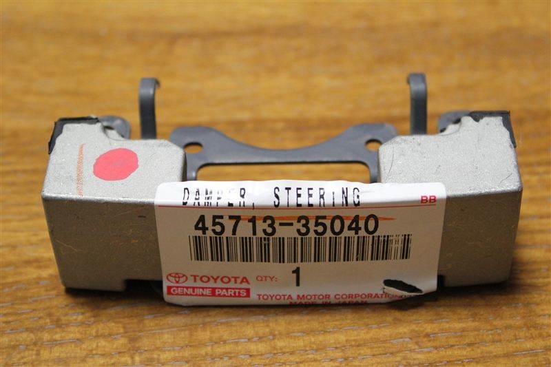

Also, has anyone tried installing a steering wheel damper to your 4runner?
I know Toyota was doing that for the tacoma's when the 3rd gens came out because of steering wheel vibration complaints.
I think our steering wheels are the same, so the same damper should work.
Worth a try maybe.
