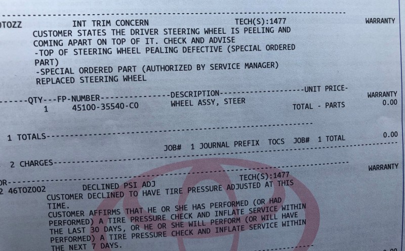

After getting pretty much ghosted by North Bakersfield I was able to get some help at Bill Wright.
I came in for my 15k service and pushed the steering wheel problem again. luckily they made good on it and 2 days later I've got a new wheel in my '17
Hopefully this will help any one else who's had this happen to theirs.

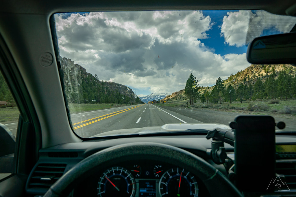

If you're looking at the steering wheel that much, you should probably get out where the view beyond it is more noteworthy :thumb3:
(to be fair, mine is pretty worn...)
