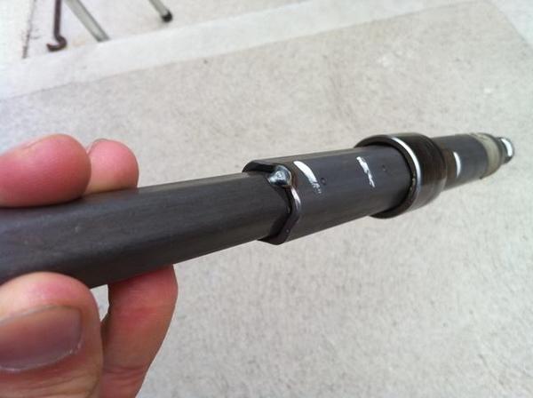

ok. i isolated the rack from the steering column. surprisingly, the rack is tight without play. the column, well, the shaft under the dash has a lot of play, which i had already suspected. could that be causing my problem(s)? i have seen the procedure for putting spot welds on it to secure it and taking things apart and it is easy. my problem is having one car, so i can't rip and tear and have it down too long. second, no one around me has a mig welder to do this, which i would rather do. unfortunately, a lot of the equipment i had, i had to sell due to certain circumstances so i am limited on what i do.
i could find me another column shaft and have it ready for a quick swap, but am not paying a couple hundred for a column just for the shaft. i have done this stuff before as older cars have the same slip joint that with time and use get sloppy.

I lost my welder too. But took my column to a local welder who does odd jobs out of his garage now that he is retired. (I just searched google maps for "welding") Cost me $10. I took mine apart and reassembled it in my driveway first, then drove the truck and the tools I needed to the welder. Popped it out again, crackle crackle, popped it in again. (So much faster the second time) All better now. Do it!!
Also took this picture with me so he knew exactly what I wanted. If you can't find a welding shop, then how about asking a muffler place?
