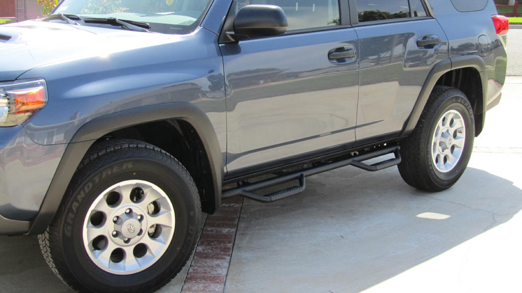

If you are not planning on doing any off-roading, I highly recommend the Westin nerf bars. I just took off the platinum series oval bars and will be cleaning them up and posting pics to sell them in the next week. A new set will run you about $350 (minus whatever discount your website of choice is offering). Myself and Wonderbreadman have some good pictures in our Garage.
